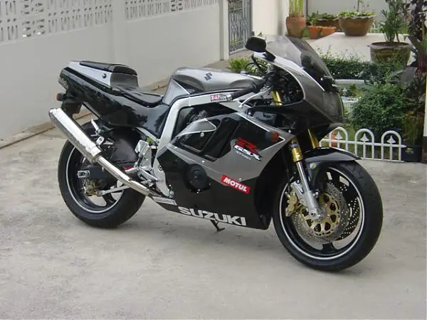

I've got a '91 GK76A But I've changed a new engine and I'm curious if anybody can tell me what year model does this engine came from?
The engine number is K709-107044
Thank you in advance
bro u got pm
Well, I got the engine from an imported storehouse in Bangkok, Thailand (2nd handed 14K mileage)
But it took me about 4 months finding a GK76A engine and hundreds of calls... most of the stores here offered me a GSF400 Bandit engine and said it has the same design except transmission ratio.
Finally I got the last imported engine from a storehouse in the suburban area of bangkok. ( After I contacted all the storehouses available in Bangkok)
The price was around 800 US$ including main harness (CDI excluded) and carburetor.
cheers,
