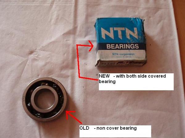

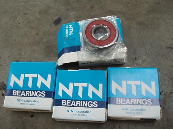

Bearing NTN 2x front wheel
Bearing NTN 2x rear wheel

NTN bearing 4x RM54

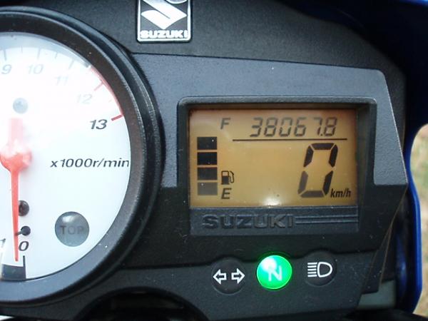

Meter : 38831

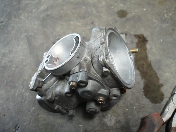

checked pilot screw - air screw - tune to 3.5 anticlockwise. Earlier was 6 turning.
the handlebar moved left right to test if the throttle cable hinders the timing
monitored if got increase / decrease in idling – NOT at all

The problem still persists. Emailed engineer
1. He said it is the main jet clogged. Need to clean thoroughly – maybe insert a steel wire and clean the tiny hole.
2. Pilot screw to 2 1/4 turns back.
3. To get the pilot screw setting, first turn the pilot screw clockwise until it seats. Then turn 2 1/4 turns anti-clockwise. This is the proper setting for pilot screw.
4. The MainJet #130 indicated in the Parts Catalogue is outdated. The correct size of MJ is #110

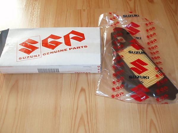

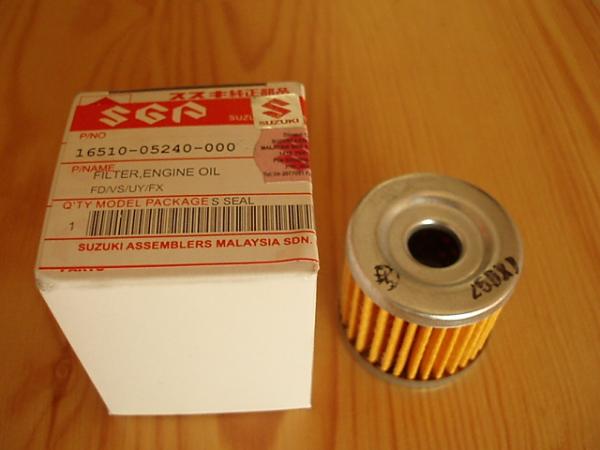

bought spare part from suzuki SC
air filter RM48
oil filter RM 5.40 x2pcs

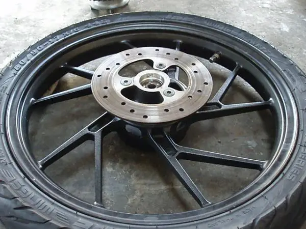

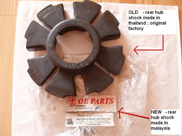

1. changed rear wheel hub RM10 suzuki made in msia
2. NTN sprocket bearing RM16 made in Japan
free labour charge

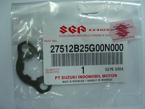

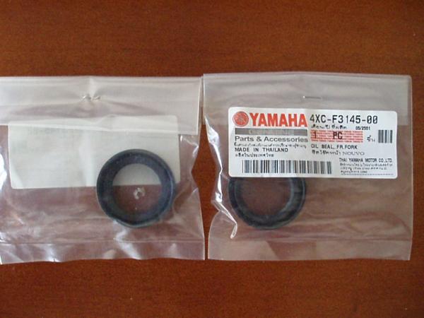

Front sprocket washer clip SGD 2.50

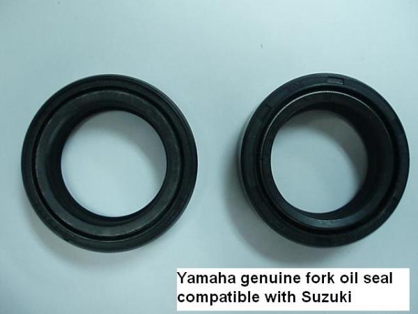

Yamaha genuine fork oil seal similar to Suzuki $ 5 * 2 LHS/RHS = $ 10

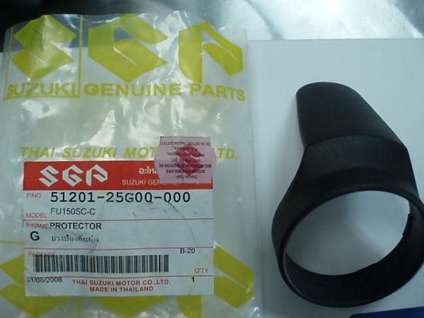

1. fork protector - 1pc RM 7.80

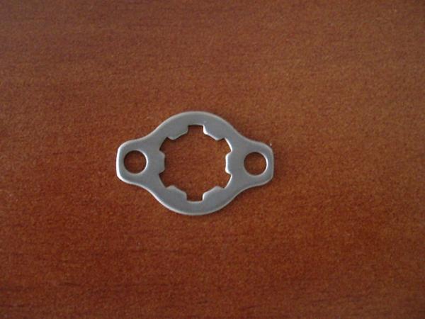

2. plate engine sprocket; front sprocket washer clip RM 1.95

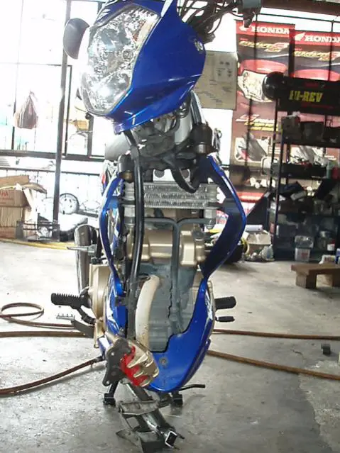

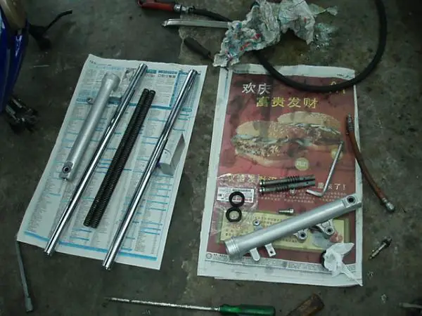

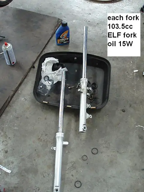

1. Changed fork oil seal with Yamaha genuine oil seal which is compatible
2. Serviced thoroughly fork and changed ELF oil 15W. Each 103.5cc

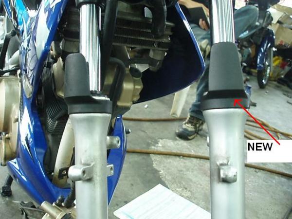

3. fixed LHS fork protector
4. serviced piston, rod and caliper front disc brake
5. fixed original Suzuki front sprocket 14T with correct washer clip
6. changed fuel tank cap/cover with new design Suzuki Shogun RR/SP
Service charge RM25
