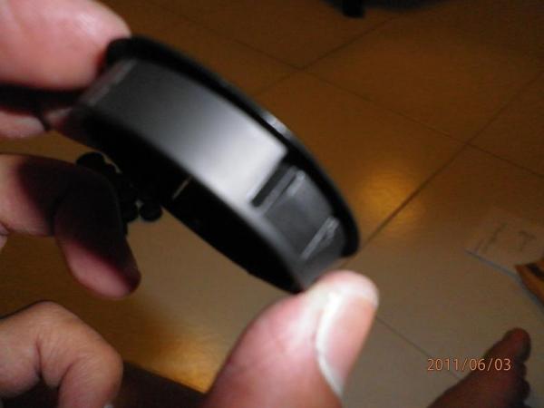

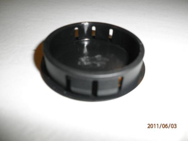

Finally the frame plugs arrive...
made of plastic...
it self locking....
Will later test & install to see how the fitting & see if secure...
of course compare to Extreme works it a heaven & earth but the pricing are poles apart...
this is more of a budget choice...lol
Wil update u all birds again...
Cheers....

the quality looks like cmi.. hehee... if its made of plastic den it cannot last long since the frame is above the engine.. lets see the outcome.. never try, never know rite... cheers

Well we will know in a week time mate...
Hope it work &u all will be saving big bucks..lol

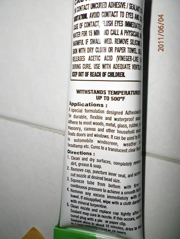

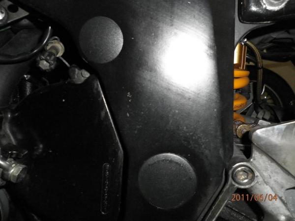

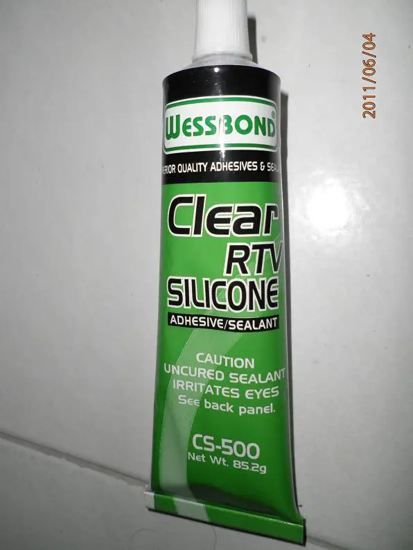

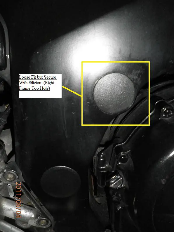

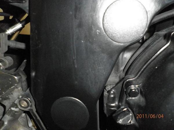

ok birds...
here are some photos of the frame plugs that I got in...
tried to find O rings like the extreme works but couldn't find at the hardware stores...
so use silicion. able to withstand heat till 500 degree F so it ard 268 degree C....
waterproof, durable & flexible...
I will test it to see if can withstand my daily usage (heat, speed grim etc)
Will update result in 2 to 3 days....
all have a tight snug fit less one hole on the right frame top one...
nt very tight but i secure all using silicon even those tight ones...
Pictures show 1st the silicion I'm using, the right frame follow by left frame follow by right frame with the abv mentioned problem & lastly the silicion i'm using (rear)...
installation just took mins... with the Frame Plugs, Silicon, Wet Tissues & "dry Tissues".
1st Wipe down the holes with wet tissues
2nd Dry them using tissues
(u can wash your bike then install oso ok)
3rd Choose the right frame plug size & apply a thin layer of silicion around the plugs
4th Push in the frame plugs & make sure it is flush with the frame
5th Wipe off any excess silicion that ooze out with wet tissues
6th Let it dry for at least 30mins or more before riding... Silicon will cure at least overnight or 24hrs...
6 easy steps...lol
If all goes well, those who order I will help u to install & secure the plugs by silicion....(since i only use 1% of the silicion..lol)
let keep our fingers cross...
Cheers!!!

Just ran an errand to Amk then to Sengkang then to Punggol...
Cruising around 110km/h to 120km/h....
in small road as usual searching for place my fan started temp gauge is 3/4....
so far the frame plugs are still going strong will update u all birds again...
Cheers!!!
