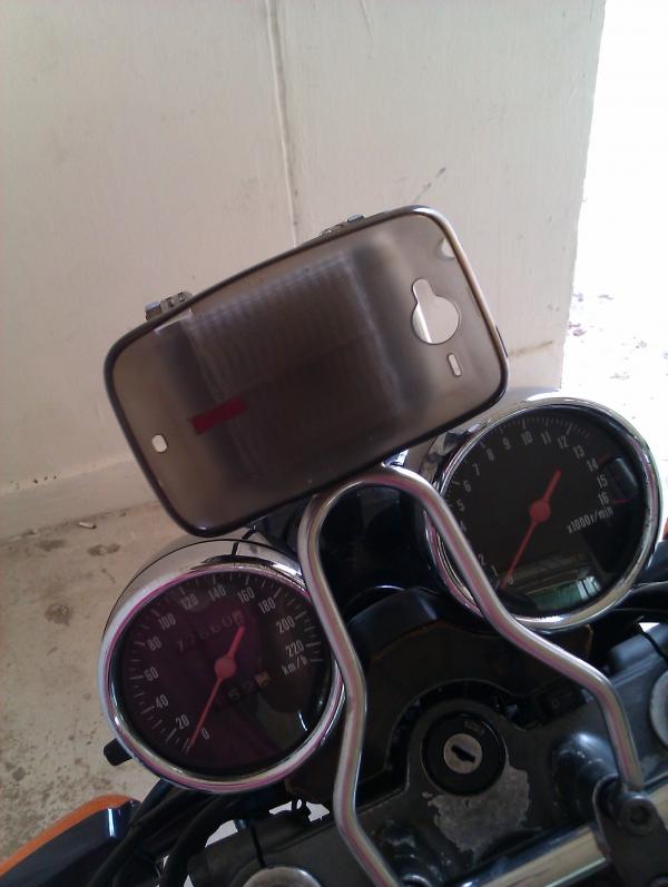

My first design was using the 3m velcro, and i've tested it on speeds up to 100kmph and it holds but if you wanna be extra safe, go for the heavy duty ones.

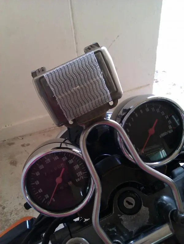

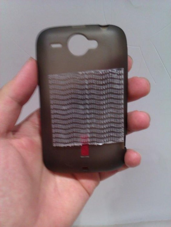

ok, clean the IU cover, and measure the width and length appropriately so it fits. do the same for your phone cover. Make sure the alignment of the fastener is correct, it won't work as well if the hooks or loops or mushroom heads are not aligned properly.
ok, now that's done. test the strength by putting your phone in the cover and attach it. try tugging and pulling to see if the adhesive will come off or if it holds very weakly.
another tip i have for those using the heavy duty fasteners is not to fasten the mushroom heads fully. it will stick too strong and when you take it off, might peel the adhesive along with it. just fasten the 4 corners and the center and you're good to go.
For those using the slim IU, one strip along the entire cover should be strong enough to hold as well, just make sure its secured fully.
