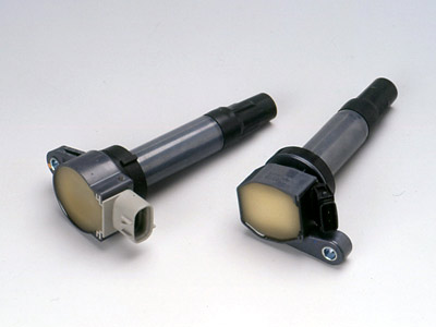

an example of a intergrated ht coil in spark cap....making it a very compact andsmall unit...thus the high tension cable is not neccesary...

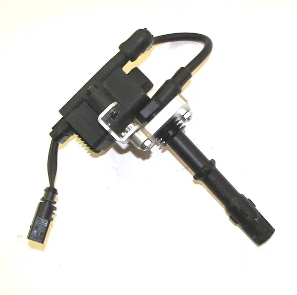

thisis sometime know as coil on plug...cop for short...
another image...this are found in cars....i have not seen any on bikes yet..not surprised on the latest bike.
Yup. This is the ignition coil. Which is why I stated previously, timing by ECU and spark by the ignition coil. Meaning the power come straight from the rotor/stator unit to the ignition coil then to the spark plug. Timing is control by ECU. No more going thru a capacitor and hence no CDI. Or am I wrong? Or should the correct term called Electronic ignition? Hahaha, I am also confused liao.
This look interesting. Haven't see this on cars before. Most of the cars I seen, have the same ignition coil found on bikes. This is more on high performance car? I doubt it will applies for bike cause usually engine space is quite compact. Usually air box above the plug at least thats what happening on most sport bike. The normal ignition coil will be more compact.
