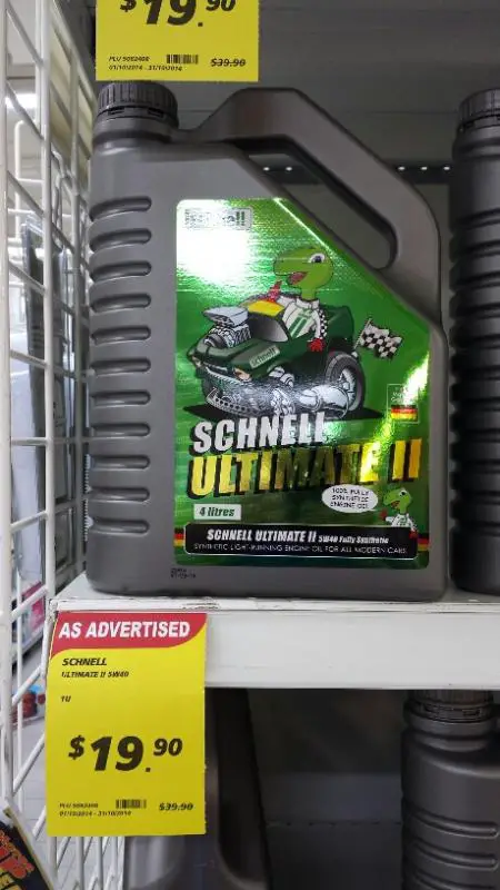

Going to get a few bottles of these for oil change:lovestruck:
For the GTS? Don't think it can use that car engine oil, can it?
