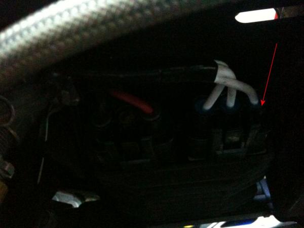

Here's a tip from the mech, let's say your batt flat, so you bring your batt to shop and recharge, once you reinstalled the batt to your bike, start up your engine, rev your bike and check the batt with multimeter/voltmeter to see if it is charging, if it is not, check the rectifier at the undertray near the rear shock, try touching it to see if it is hot, if it is hot, then the rectifier spoil, if it is cold that means its not getting the current from the coil. following pictures will show what to do...

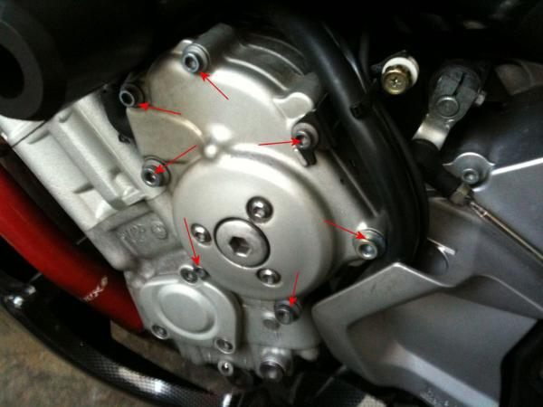

You will need to disconnect the cables from the rectifier, you will also need to lift the fuel tank up so you can pull the cables. Then unscrew the nuts as shown in the second picture which is located on left hand side of the bike.....once unscrewed, open the cover and you can see the coil and magnets. Do take note though, once you've opened the cover, you may need to replace the gasket....

ur bike is the 07 model? mileage how much already? might wanna look into the mileage n determine the time of failure for the coil.
hmm.... rectifier shd b hot when in operation rite?
so, no charging, rectifier hot = rectifier defective. then, no charging, rectifier cold = coil prob.
