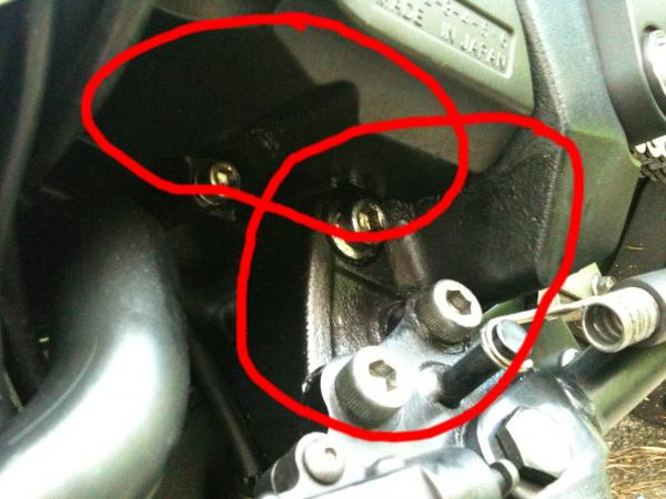

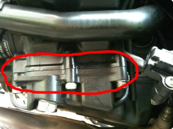

guys i left my bike parked last 4 days untouched due to work. when i came back i spotted about a palm size oily patch just around the left leg of the main stand (sidestand side). at first i tot its due to the scottoiler thinking if i may overlube it but when i check again, i was wrong. i touch it and it was black in colour. it came from the left side of the engine. EO leaking? arrghh.. only 6mths old..
wat it could be n the cause of it?
will warranty cover? (but i never went yamaha agent before for servicing)
I had a similar problem recently, turned out to the gear shaft oil seal. Changed that and a couple of other seals, seems to be ok now. Of course, my bike's a lot older than yours - you really shouldn't be having this within the first 6 months! I think it's worth taking back to the dealer and seeing what they have to say. Even if it hasn't been serviced by them, it's not like your workshop is fiddling with these seals during an oil change.
Again, oil leak could be from any number of places, so don't just rely on what happened to me. But in my experience, the timing of the leak could give a clue as to where it's coming from. For instance, since my leak was from the gear shaft, it only leaked while running or immediately after. Once parked, the oil settled down into the sump and the leak stopped after some time.
Check your rear tyre for signs of oil splatter - this will tell you if your oil is leaking while running or only while parked. Since you don't notice the oil when you park overnight (only after a few days), this should provide some clue as to the location of the leak. What exactly it means, I have no idea.. sorry :angel:

guys i left my bike parked last 4 days untouched due to work. when i came back i spotted about a palm size oily patch just around the left leg of the main stand (sidestand side). at first i tot its due to the scottoiler thinking if i may overlube it but when i check again, i was wrong. i touch it and it was black in colour. it came from the left side of the engine. any possibilities of EO leaking? arrghh.. only 6mths old..
bro, try to clean that area (or ur bike up) and lower the volume of your scott oiler and monitor for a few days see if such thing still occurs or not before looking into the real problem...
in my view, if u go back to agent with such situation without telling them more information, it's kinda hard for them to tell u exactly what is the problem and fix that problem...
perhaps we can review that again in a few days time? :)
Have u clean your front sprocket before? You will be surprise how dirty the front sprocket can be. maybe clean up the front sprocket area first to determine where the oil is coming from. maybe your scottoiler on too much oil. For me, my scottoiler is on 1.8. can see the chains is wet will do.
