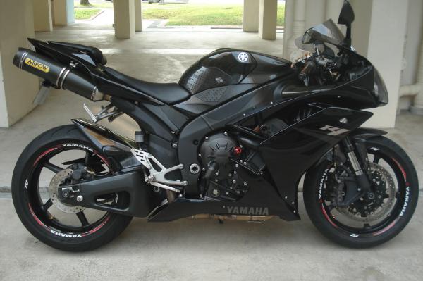

dolf what is a fz1rr???
haha...DSC00400.jpgfz1rr
http://i757.photobucket.com/albums/xx217/dolf_sg/393916_10150493355642218_551227217_8959469_1615068476_n-Copy-1.jpg

looks like a naked bike... is it fz1n?
