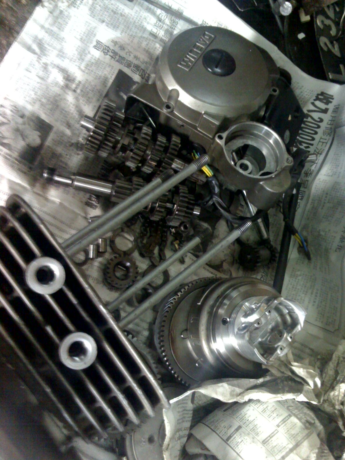

hi raden/lost jackal,
bit quite a while since i last posted to this forum. just completed modification on my roadwin. full mod. changed my piston, sizing my cam-shaft, changed my carb to tzm carb....etc. haven't got chance to fully test it. need to run 1000km to "cook"
the piston 1st. had sprayed new colour (yellow). wl send pics and maybe video once ok. one thing is sure, the accelaration so so so so syiok.
by the way, congrat on winning the asean cup.
bye
nazri
bye
nazri

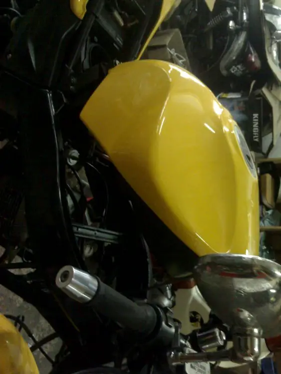

don worry bro. will advise u. meantime, my fren mech modified my tank so it open like aprillia rs125. neat r?
bye
nazri
