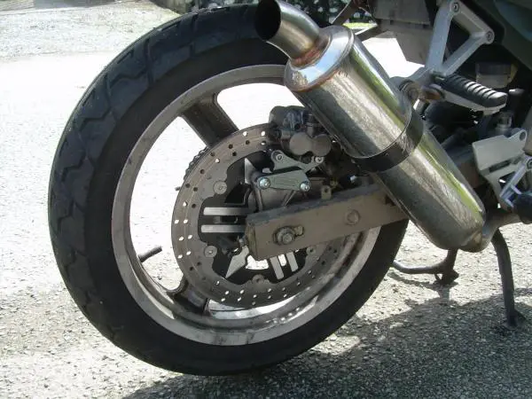

it is big, looks more like for the front wheel.
rear wheel disc is purposely design to be small n less stopping power to prevent wheel lock.
just be very careful n brake gently in emergency, it will lock your rear wheel.
