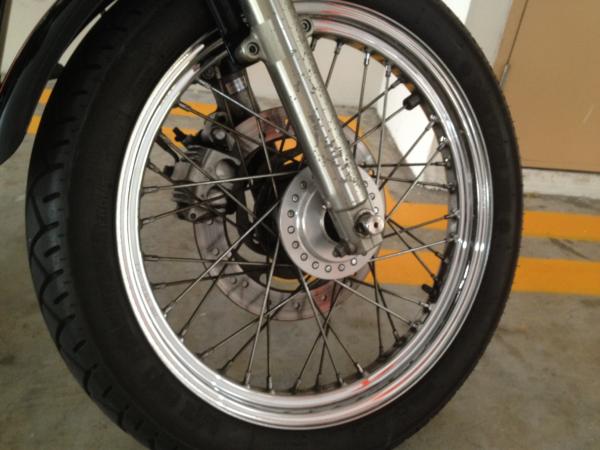

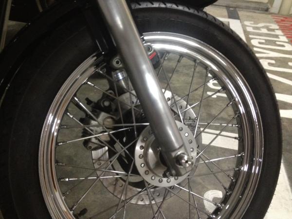

Wanna share some ideas that i apply to remove the lower fork oxidation.
A couple of scotch brite and metal polish is able to remove most of the affected area in the lower fork. After that use a polishing cloth to buff up the shine and protect it. Apply some wax on polish metal to make it last longer. I hope this will help riders sharing the same problem. :)
PS: The whole thing would cost less than $10 but it require some efforts.
hi, what metal polish you are using ?
I used Turtle wax metal polish. You can get it at Mustafa centre. ;)
Actually the lower fork come with a clear coat from the manufacturer. Once u remove the clear coat on the lower it should look much better. Will try to post the before and after picture later.
Here is the before and after pictures. Hope it helps.
