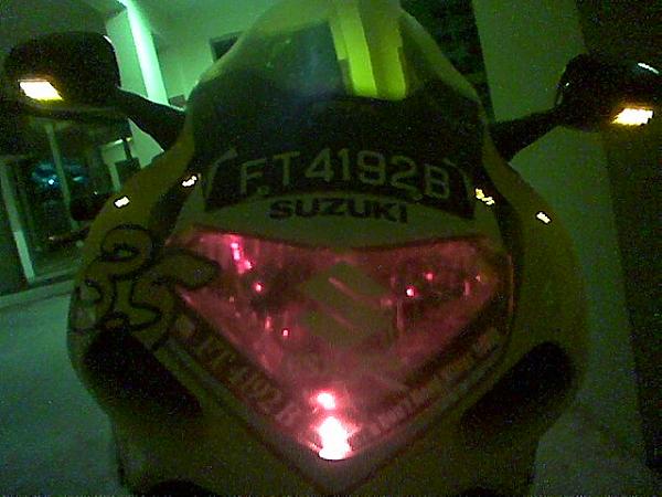

hi all, any one care to share how to go about connecting tis light (d 2 small light with red arrow pointing)? is it to head light connection? if i wan to add a ON/OFF switch to it, where can i get it?

my sp already haf tat light install when i bought it, but jus de connection part is not connected to the connector. my question is how do i go bout connecting it to the connector?
do u wan it to be on wen ur headlight is on..if yes, u can tap the power to the headlight..

1st u need the followings:
a) wires
b) on/off switch
c) SP signal-light x 2 (go LAB buy, should be less than $30 for a pair)
1) remove the signal light & use the connector onli
2) drill a hole to the size of the connector @ yr headligh (u need to remove front fairing to drill)
3) connect wiring to connectors, merge both e wrings of the connector into 1. den to a switch den to yr bike ign. fuse.
& yes, it's just tat easy.
tat's wat i did on my 01' GSX-R 750 years back.

ask fnee, main thing is :
- create hole in ur headlight to insert the t10/LED, btw u nid a t10 socket if u using t10
- switch
- wires..
and some electrical knowledge

Thks for ur info LollyPoP.... but can u pls elaborate more on the connection part.... thks ......
