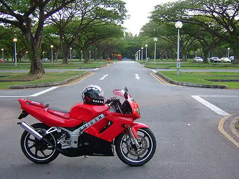

below is my bike after resprayed it after an accident.. and thankfully, the paint is still the same until now.. cheers!
