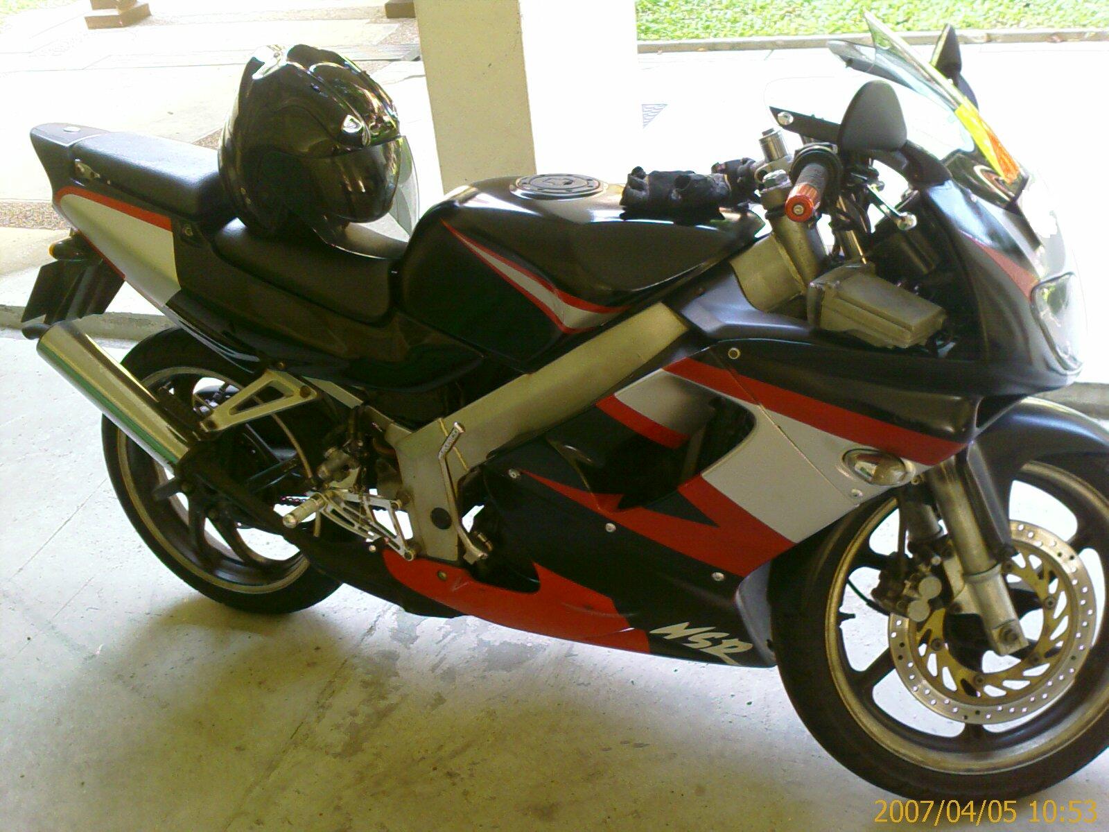

Yo bro, just to add the very importance of sun in spray painting.. especially during lacquering part.. no sun = milky lacquer .. and for those who are trying it out first time,, u might wanna just test it on an old helmet first to get the hang of it... spray pressure and distance to spray is also very critical.. spray too far..wasting paint... spray too near.. blotches here n there.. so to avoid heartache on the fairings... khekh.. might wanna try it out on an old helmet first..khkeheke..
btw, i must say its quite a rewarding feeling to have able to spray your own bike. however, it must not be a rush job.. trying to finish up in a day would only aggravate the quality as we tend to rush thru the coatings...
Just offering my two cents to those whu wanna try it out.. :)
below is my bike after resprayed it after an accident.. and thankfully, the paint is still the same until now.. cheers!

yup yup.. RJAY brand.. 3 coats paint.. 3 coats lacquer.. :)
