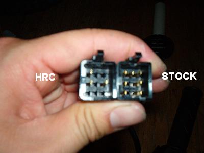

no problem. I recently found a source for hrc parts in the net . will check out which is one is cheaper . So you want to use the rc51 switch or the cbr 1k ones ? Both also need to rewire abit .

Actually what is this switch used for? Can you share to us?
hrc provided starter and off switch does not have the front brake light wiring connection . So you your brake light would lid up , when you use the front brake . By using a RC51 or cbr1k ones ( b'cos both type switches is separated from the throttle body ) and rewire to your bike then youwill have front brake light work.
The other way is to use hrc switch and add 2 wire to the brake light switch .

Just to add on, cbr1k start/stop switch is using a different connector from cbr600rr. I did the swap and for the sake of neatness and reliability, I bought new connectors to crimp onto the 1k start/stop switch. The connectors are ordered from overseas. I have 2 more spare sets so if anyone is interested pm me. Selling $10 per set. Includes male and female plugs and pins.

Is a 9 pin honda plug... fits my CBR600RR. Same as the one in your pic.

About 77USD for the kit exclusive freight.
Installation is PITA and not for the technically challenged. U need to get to your throttle body to replace the throttle cables. That would mean removal of the tank and airbox. U will also need to drill 2 additional holes in the right clip-on. 1 to position the 1krr start/stop switch. Another to position the throttle. The stock hole on the clip-on cannot be used.

i'm not riding a 600rr . i'm on a 954 so have to check out weather will it fit first .
