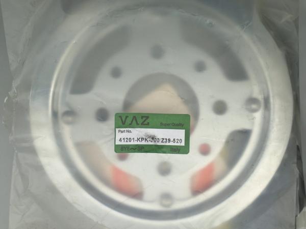

Hi naim,
Don't manage to get a 39T from Eversuccess so I go try LAB again.
Today is my lucky day manage to get 1 from LAB @ $35 quality not bad (VAZ brand from italy).
My bike shop say must cut abit if not too loose :cheeky:
The pick up lost abit at an acceptable speed actually quit surprise still strong at gear 1 and 2nd gear can drag more now :)
Have no time to run longer distance but will try tonight but the normal drive is much smooth now especially during hot weather in the afternoon.

Wahh how come no stock. I rmb it was only 20+ i got last year. Nvm la at least u got quality one. Hope can last long. So did u shorten ur chain?
Yup d riding is much nicer wif it. Can drag longer and make use of d lower end torque. Enjoy d ride! :)
:thumb:
Actually they said they have 1 but is without plate just the gear I was thinking how to mount without the plate... so go LAB try my luck. The chain is shorten by my mech he say too long. :)

I got the smaller rear sprocket (for Honda SP), still using it today, hit top speed 153km/hr down slope on the NSHW, but it took a long long time to build up to that speed. :lol:
Champion already. Hahaha!

Without the down slope can hit 140km/hr?
I use 37T can hit 120km/hr with pillion.
Hmmm SP or Phantom speed? Is it actual speed? Cause last time my SP can hit 140km/h (meter speed) easily.
Ok now i understand what he meant. Speed of 153 on Phantom with a sprocket meant for SP. :cheeky:

Yap, 153km/hr was on the Phantom meter. Spocket was meant for the Honda SP, but I used it anyway.
Pickup was not slightly less responsive, but not by much, anyway I am not the type to ram full throttle at once the lights turns green. :cheeky:
After a few days you will hardly notice it. :angel:
Or at least LL suck thumb and forget it! :lol:
On flat ground can go until 135km/hr, but it takes time climbing after 120km/hr. Going up slope full throttle only 120km/hr max. :(
