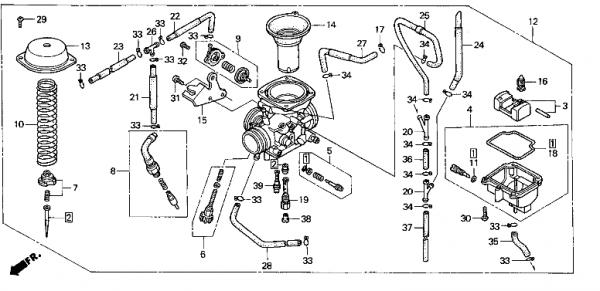

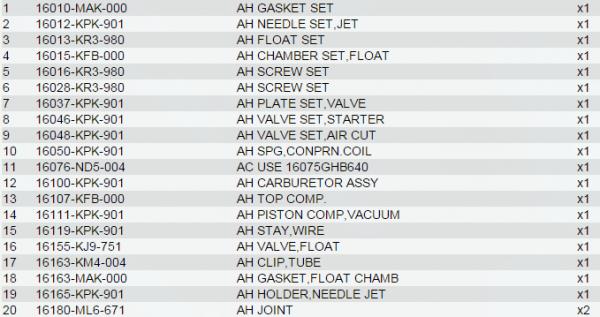

Anyone know how much for phantom carb gasket and o rings? Do they sell a kit set? How muchie? Mine is old n the rubber is dry.
In case you need the pictures and part number
Only know it's a CV type some VE variant which I can't find info online. Left and right large diameter tubes connect to air filter and cylinder head respectively. The down tube from the carb bowl connects to overflow valve for the carb bowl.

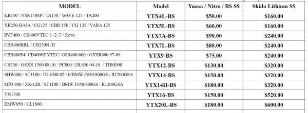

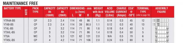

The price list is from Unique Motorsports. Think on the bright side you are in fact getting a higher spec battery
