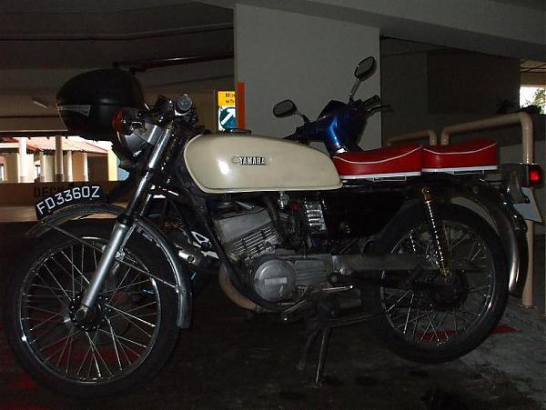

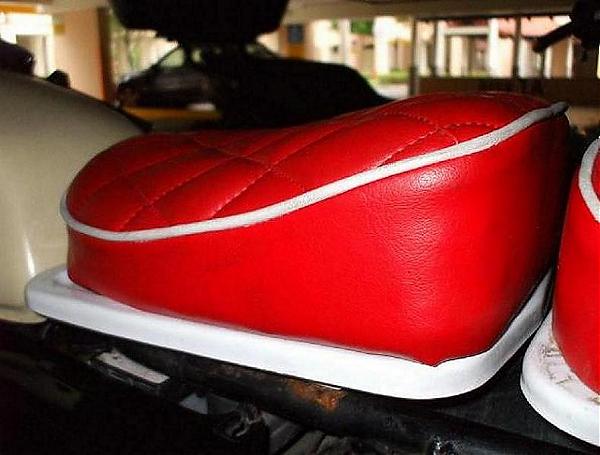

Brake pads any shop can do. It's a simple affair. Any chance you took a foto of your seat? Is it original or u changed to something else?

This is how my seat looks like.
And i just change the rear mudguard which i think its ugly.
Honestly speaking the more i look at my bike, the uglier i feel it is.
