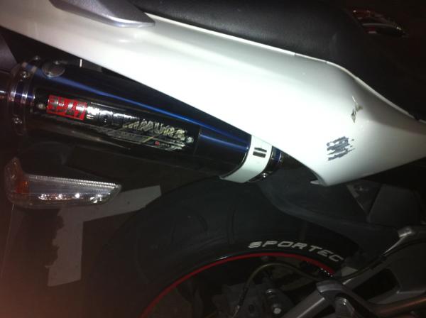

Bad luck yesterday. Skid in parking and damaged the bike. The lovely ivory pain got a dirty scratch and the Yoshimura also bent inside and got scratched.
will post the picks later .. so as u guys could advise the best possible way to get the beauty back with min cost.
Edited by nee_savi
Adding Pic
