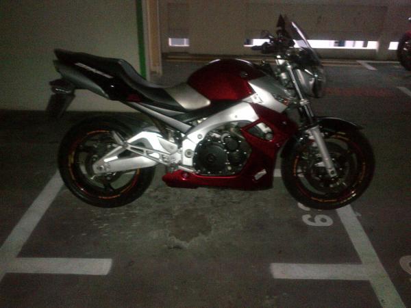

[ATTACH=CONFIG]240320[/ATTACH] my project done! Can't wait for the meetups??!! Is there any the coming week??
bro, your belly pan...... where to get it?

Lexane has tried contacting cross over but i think to no avail. HAHA i am sourcing other fabricator lets hope there is something.
No worries, is Dervin available? I'll contact him again, he's busy or something.
Though if addy is able to tell us where he got his from....then that'll be awesome!
