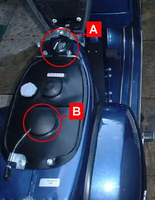

zen > A is supposed to be hollow.it's the air intake for vespas.every vespa has it. hmmm...B,gd qn, is it for the fuel gauge?

zen> the tap could be change. No harm running it when its on reserve. Downside u wont know when u are running on reserve fuel. For ur quention A) is to allow for cold air to enter for ur carb air intake.
B) Its the hole for the fuel float. Device to determine the amt of fuel in the tank.
the pic u posted is the one with a seperate 2t reservoir..

hey, more questions :) please refer to attached pix (taken from internet)
what is A and is it suppose to hollow inside? it just look very naked and unfinised on my bike...like something's missing?
what is B and how does it serve the machine?

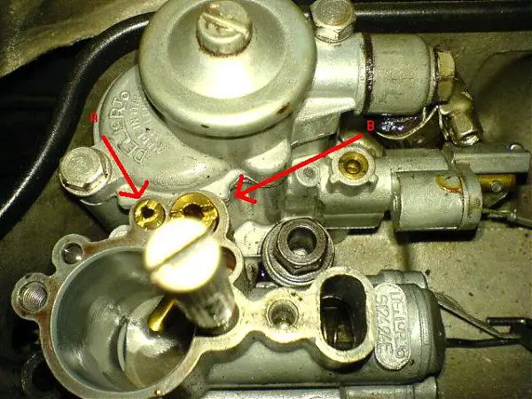

ok guys, i just open up my carburattor box.. this cooper like pin labled A and B. may i know what function does this two serve? labled A, this is what i read from the engrave, 55 160 Lable B 116 BE3 160 ..please advice. i know this is a modifled parts, but i just wanna know the performance and hopefully some details... thanks in advance.

the one labelled B is your main stack
and A is your slow running jet
they're used for fuel+air mixture to be burnt when running and idling.
im not sure wats the function of A. Cos seldom touch the part. But B) is definetely the onli thing on the carb i constantly (and most of us)fiddle with. Thats the main jet stack. With the numbers u give u are oviously running on the 24/24 carb with standard jettings. thats to determine the amt of fuel that flows into the carb. the bigger the number the more fuel is consumed. theres a rage of how big or how small u can go depending on wat engine setup u are running.
for a rough guide if u are running a stock 150 with alloy block most would recommended 118 or 120 main jet. and u onli change the end tip. if ur engine is highly modified ( cut up crank, ported, alloy) min is 125 largest will be ard 130. For 200 cc engine i have no experience with it.
