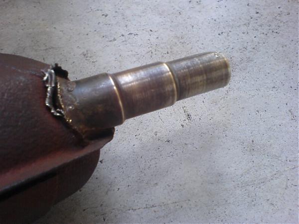

hey peeps... was wondering, beside this kind of exhase pipe (cooper)...is there any other design around? and which is better and recomanded? the smaller the "output" of the pipe, the louder the sound?
mine is just a cylindrical piece of metal..
it used to be what u have,but when i tong-ed my exhaust at Cik Ali's, he cut out the old copper tip

he cut put the old copper tip ? then what is left ? okay, so is cik ali good at all this ?

he cut out the old copper tip ? then what is left ? okay, so is cik ali good at all this ? and i notice somthing in the exhase pipe, there are black rubber mash in it... is that supose to reduce the sound ?
he cut out the old copper tip,the one u have in ur pic and he put in a cylindrical piece of metal.
I bought a used original stock px200 exhaust and brought it to Cik Ali for tonging.if you wanna hear the diff just come down and take a look at my ratty px200
