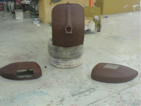

thinking of getting my scoot media blasted when the time comes for it to have a new coat of paint.
qn,is there a difference between forks of a px that has drum brakes and one that has disc brakes or is it just in the hub?
and why are the blasting services located so far away?

there u go james....blasting shops!! not one but 2...hey hey, internet is the way to go ...
haha...company is bnp which is selling THE scorpion product range haha
:gun: ABCDEFGHIJKLMNOPQRSTUVWXYZ :bouncefire:
um... good question cephelix... I wonder how accurate this $500 tag is though...
I think BNP does actually do the work... perhaps this scorpion one doesn't... need to check out

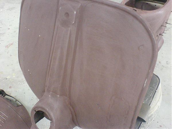

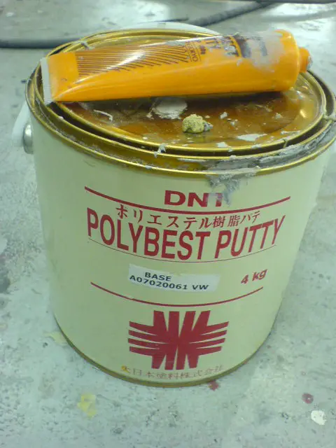

this is what they apply to the surface after anti-rust coating. putty/primer. after which thy will sand down the surface once again to even up the surface b4 the actual paint work.
from what I've read on the scooterbbs archives... this kind of bondo (filler) (putty) is fine... and applying it in a thin coating everywhere is standard practice to ensure a nice smooth paint finish... with an old frame like yours there'd be plenty of ripples and bumps in the paint finish if you didn't use it...

and yeah,the putty thing is normal to apply a thin layer...
it only becomes wrong when it's used as a filler
