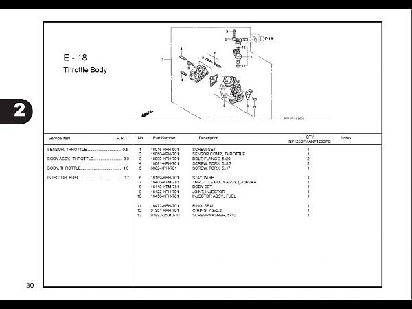

. Fuel injector change.....it's the electronic thingy fused with the Fuel injector that's bad.....but the electronic component comes as a whole assy with the Injector......
someone stated this is the part thats needed to change but it costs ard $200 plus - will go to the jalan besar shop to check it out.

hey silver surfer u know the full name or part number of the fuel injector?
issit fuel injector assembly?

yo flykite what is the part name exactly that needs to be changed?
i wanna try ask around at jalan besar plaza or fjt see they have or not.
if i am not wrong, just the cdi needs to be changed, or re-programmed.

im cnfused... need to change the fuel injector assy or change the cdi?

here is nologicones post
Problem SOLVED!!!!!
By Ah Lih @ Wing Yap AMK. Fuel injector change.....it's the electronic thingy fused with the Fuel injector that's bad.....but the electronic component comes as a whole assy with the Injector......
Ah Lih's is friendly towards me, and he really did tried lots of options. I mean, he has never done this before and my Wave i was the 1st for him to try. 2 weeks to finally solve and rectify..... Oh, did I mentioned that he ONLY ordered the Fuel Injector after getting my consent as it cost $300plus??? This is what I like, instead of installing it then charging me until I . To me I find Ah Lih very steady, and honest. Will deal with him in future, definately!!!
$400 inclusive of labour. Yup, it's a bit ex, but it's perfectly solved, and he test ride the bike before handing it back to you. And my bike was washed too...... I rather pay abit more to solve it there and then, rather to bring it all over Sg and in the end, cannot fix and spend more $$$.
