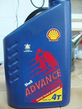

only use 20w-50 or 20w-40 or 15w-50 balck oil viscosity
do not use anything other then that
yamaha crankshaft bearing and clutch housing rubber damping cannot last long
the final mileage it can last is 55,000km
so it need thick oil to protect the bearing.
yamaha bearing faulty in gearbox is well known
long term use has problems:angry:

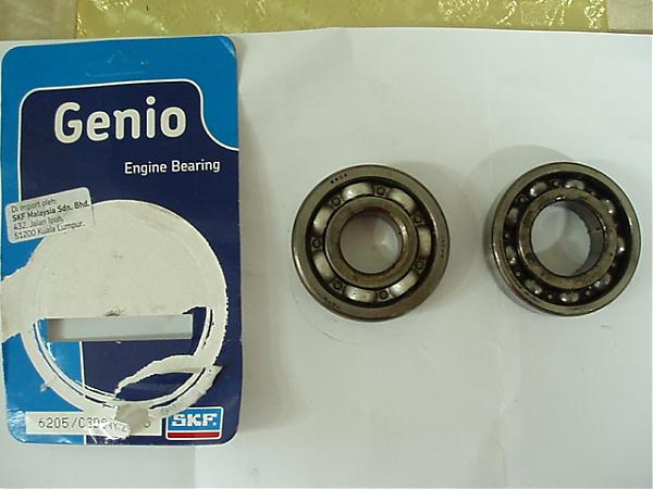

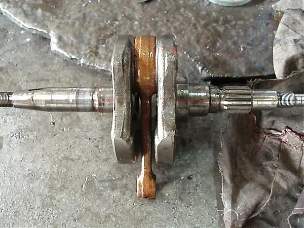

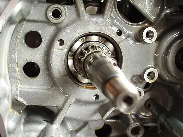

Guys,
I just did overhaul on my bike.
Date: 28 April 2008
Shop: Seng Fong Motor Boring Trading, Jalan Larkin, Johor Bahru
Location; No. 12-A jalan Larkin, 80200 JB
tel: 07 2243670, 017-7726720
Thank you very much for your kindness consideration. By God's Grace.
Please consider the environment before printing this e-mail; Save trees
www.heritagebaptist.org
www.worldvision.org
www.cfcindia.com
http://www.e-sword.net/downloads.html free God's Word
Meter: 70463
Date: 28 April 2008
Total: RM360
Time: 10:10am – 3pm
Overhaul engine due to Yamaha defect on crankshaft bearing – design error, not enough ‘tembaga’ thickness on crankshaft.
Suggestion:
Use 20w-40 engine oil
The best is Shell advance S4T
Synthetic oils are good for piston and piston rings
For gearbox protection ad bearings, suggested on thicker oil
Furthermore, motorcycle and car engine oil has different purpose
Car engine and gearbox oil are different
Solution:
Lay crankshaft rod and welding to add more ‘tembaga’
Changed 2 bearing of crankshaft (left and right hand side)
Gasket one whole set
Timing chain rod – guide stopper 2 pieces. Comes in a Pasir
Exhaust pipe inner gasket silencer
Front fork oil change
Labour charges
Extra:
Did ‘double side tape’ layout for anti vibration on fairings and cowlings.
Exhaust pipe paint high temperature black paint
Changed air filter
Chain drive sprayed Putoline GP1 chain jelly
Adjusted kick starter position for shorter and smoother kicking
Oil lubricant into throttle cable and inside throttle for smoothness
Changed engine oil - for 200km running to clean and wash out all the residue.

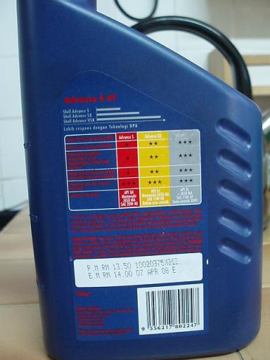

I received email from Shell Malaysia
answering my question on shell advance s4t oil
below i copy , paste
Hi Mr.Gxxxxxx,
Good Morning...
Thank you for taking the time to write in to us.With regards to
your earlier enquiry regarding our Shell Lubricant,especially on the
qualities of the Shell Advance S4T,it is an oil is designed to
withstand and remove the heat generated in the motorcycle engine.
The temperature is not an indication of the heat generated. As a
guide, the maximum temperature the oil can withstand is indicated by
the flash point, which is about 200 deg C.
To prevent imitation, please purchase from our approved Shell outlets
only. If the you have come across suspected imitation products,
please report to us the location & address if possible of the outlet
for further investigation.

29/5/08 meter 73127 changed shell advanced 4T RM13
24/6/08 meter 74700 changed shell advanced 4T RM13
so approximately I change engine oil for yamaha spark z at
1500km :thumb:
