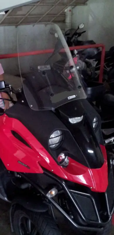

woah.. v nice price.. tink stick to my givi hahah..
but i tink madstad is a good screen, nice adjustable angle for city riding or touring..
Selling Madstad adjustable windscreen de kit from my ex bike. $150
