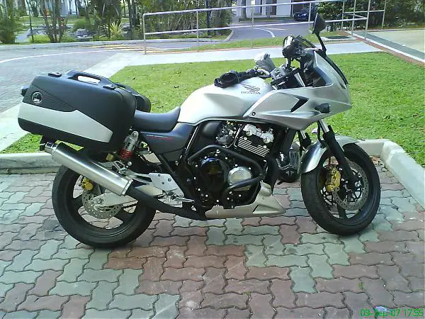

There u go... i havent modify tthe rack yet.. planning to go SK soon to make the boxes lower & more behind coz itz blockin my pillion whenever she wanna get up...
Before
Racks have not been modified yet.. notice how front the box is..
After
Racks have been modified by SK... Slightly to the rear & lowered abit.. but im still not happy.. i modified it when i was still using the stock exhaust & thats the lowest SK can bring the box down.. im tinkin of bringin the boxes lower like those on TDMs.. whad u guys tink??
i dun think you can bring it down too low. not enough clearance for the ground. and if you keep your morawaki exhaust, your case will block the fumes which will melt your box during high rev. You might wanna consider getting a 30lt junior for you right side so it will come out a bit and hang beside your exhaust. But not too low. and you can get SK to align the case to the ground, it look very slanted.
Before
[ATTACH]52091[/ATTACH]
After
[ATTACH]52092[/ATTACH]
i think you can further lower it down.. and try to make it straighter.. it's very nice.. someday must meet up with you to admire your set up!!
regarding the exhaust fumes issues, you can try sticking some heat insulation on your right box to prevent it from "melting/warping".. (not sure if the material will be melted by constant heat by your exhaust fumes)
thks for the suggestions guys!!!! ;)

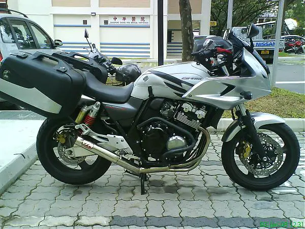

pls look at my pic below...
http://photos-566.friendster.com/e1/photos/66/56/31526566/1_504841992l.jpg
the way i setup my Wingrack,
look at the gap space between my exhaust and the Right-side pannier,
went KL and back,
no issue of the box deformed due to exhaust heat...
my 2 cents... :dot:
went KL and back,
my 2 cents... :dot:
went KL and back,
my 2 cents... :dot:
bro,
my previous one also wun melt the box, because Yoshi pipes are cambered horizonally out.. look at Moriwaki one, it's angled up..
if really lowering the boxes, the underside of right box may kena..
Get a Moriwaki short Fullsystem..!! then customise your boxes in whatever way.. Legal 100%!!
