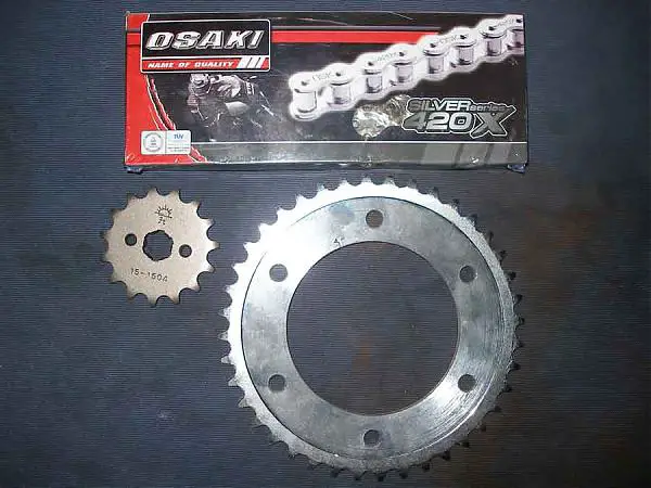

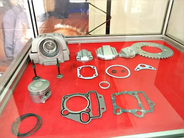

currently im using a 24mm carb with a 135cc big bore kit. and samaller front and rear sprocket..im happy with the results but im still trying to trial and error cos i wanna go to 150cc maybe 160cc..
if any of you guys need the 135cc big bore kit i can try and get it for you..full set with bigger camshaft..if we can get more people then we can share the shipping..and best of all it wont cost you more than 300 bucks with shipping.

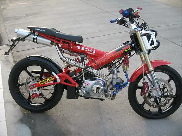

if you guys wanna used the 26mm carb your engine would have to look something like this...got to remove your air filter box and use power filter with intake manifold that go side way cos you wont have room for your big carb.
if you wanna fix the oil cooler. that space is the best for me...
i got an inverted fork something like this but have yet to fix..
