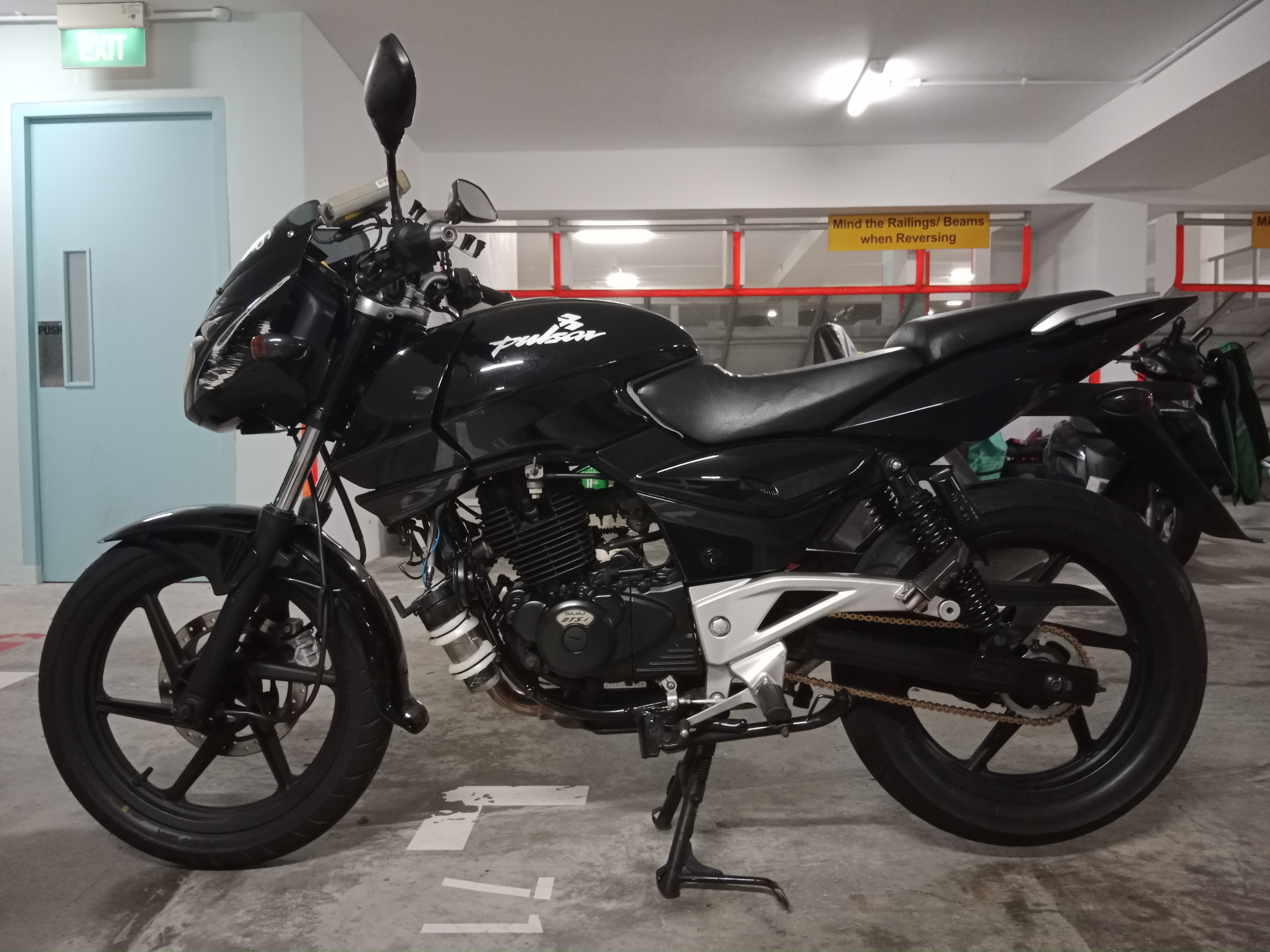

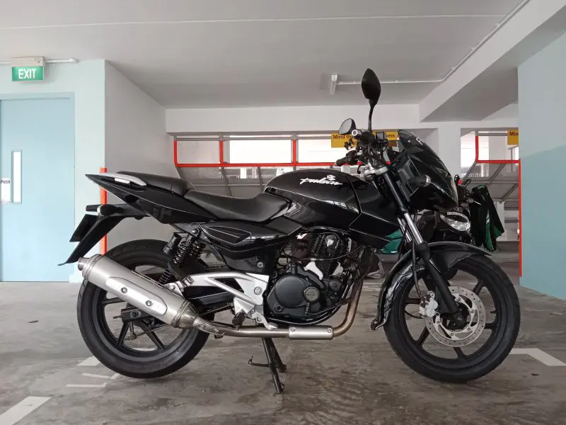

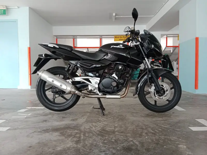

Front tyres have been changed from  Bridgestone Battalax BT39 90/80-17 to a mild size of Battalax BT39SS 100/80-17 to correct the rake angle of the bike with picture before on top and after at the bottom. This also allow more front wind to flow through the oil coolers increasing cooling efficiency of the coolers load for the engine when high speed cruise is needed. Until the new fatter fork arrives with a Billet 7075 Aluminum top triple clamp being CNC. I will then change to a Bridgestone Batallax BT-39SS 100/90-17 front tyres and a linger range play swingarm to compensate again for the rake angle of the bike.
Edited by ConceptFuel
Spelling correction.
  • Like 1

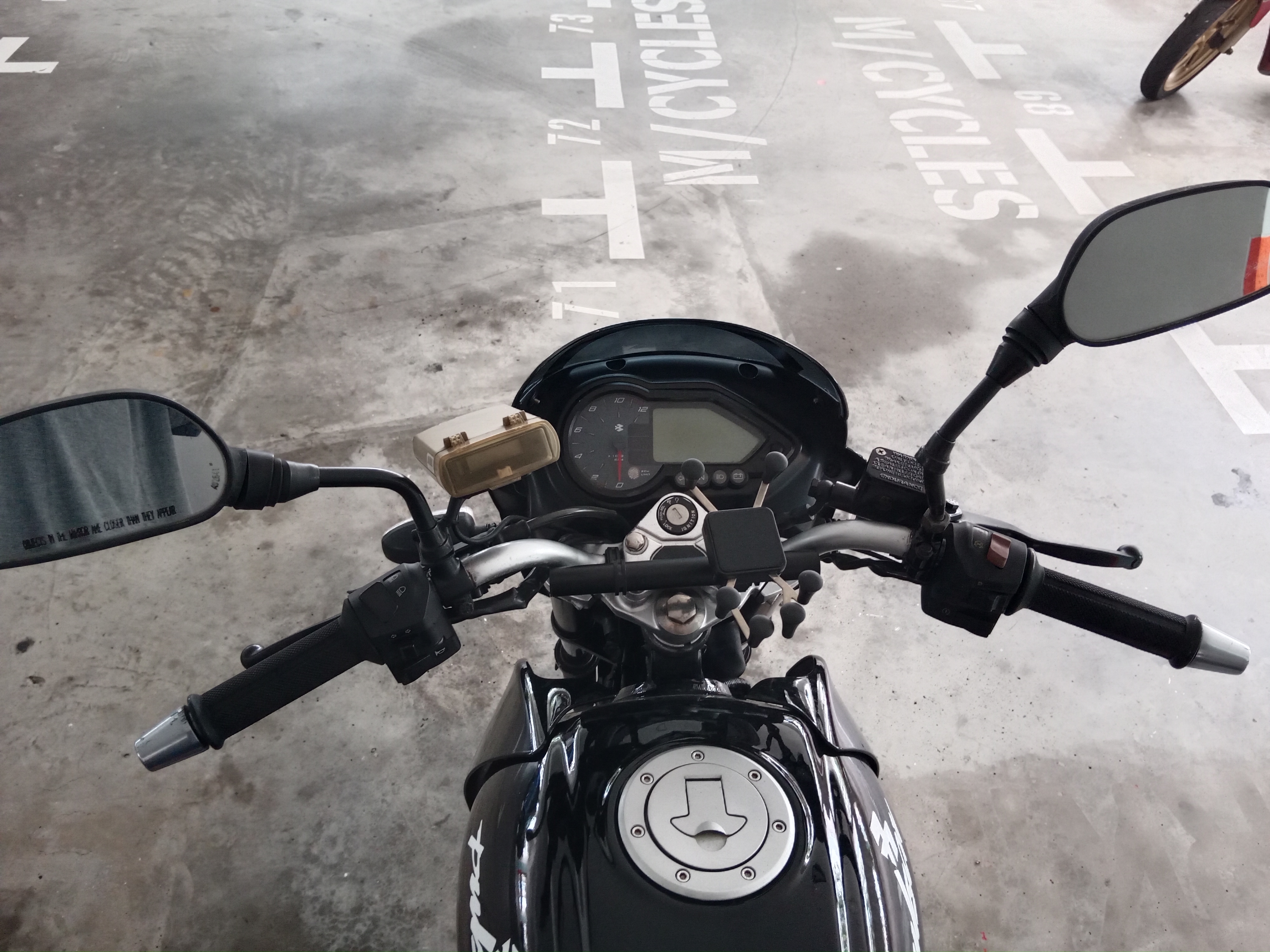

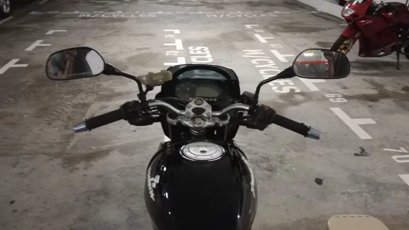

Discovered when I took the the bike out from the shop, the handlebar was also not original. As it was fitted to a higher angle Pulsar 150 and 180 handlebar ones, I change it to the lower angle of the Pulsar 200 handlebar, which is also slightly wider by 2cm. Old one is on top while as usual new is below. Sorry I forget to remove the mount to notice the difference more easily 🤦🏻‍♂️

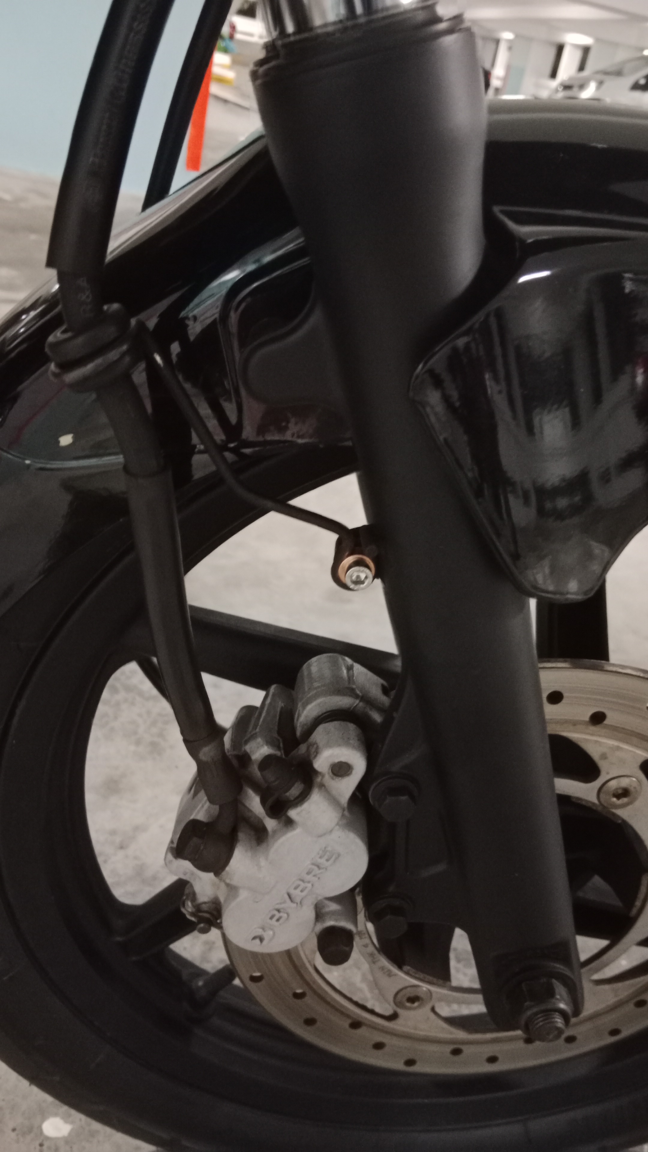

Lastly for now some small touches, the front brake hose guider hold at the fork was missing and keep rubbing the front fender, I just decided to install the original mount but with different grade screw and washer instead of stock mild steel screw and washer which tend to rush under weather. Stainless Steel 318L with polish copper would be nice.
  • Like 1
11 hours ago, ConceptFuel said:
Alright since things are still on planning and awaiting some renewal parts arrival, I have done a small weight reduction, reliability and also some neat representative look on the bike. The day time picture is the original daytime of original signal light which I have replace it with a night time picture signal light. Is slightly lighter with 30grams reduction, then old signal light also tend to shake due to aged rubber mount, and also making things at the rear look neat without hinder in safety aspect with laws also. I decided to still stick to classic conventional filament signal light as to not give out too sharp light output to other road users while it still visible to other road users eyes. And yes to me of course, it looks better as a bonus.

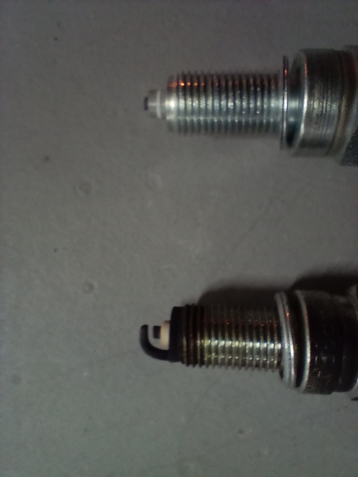

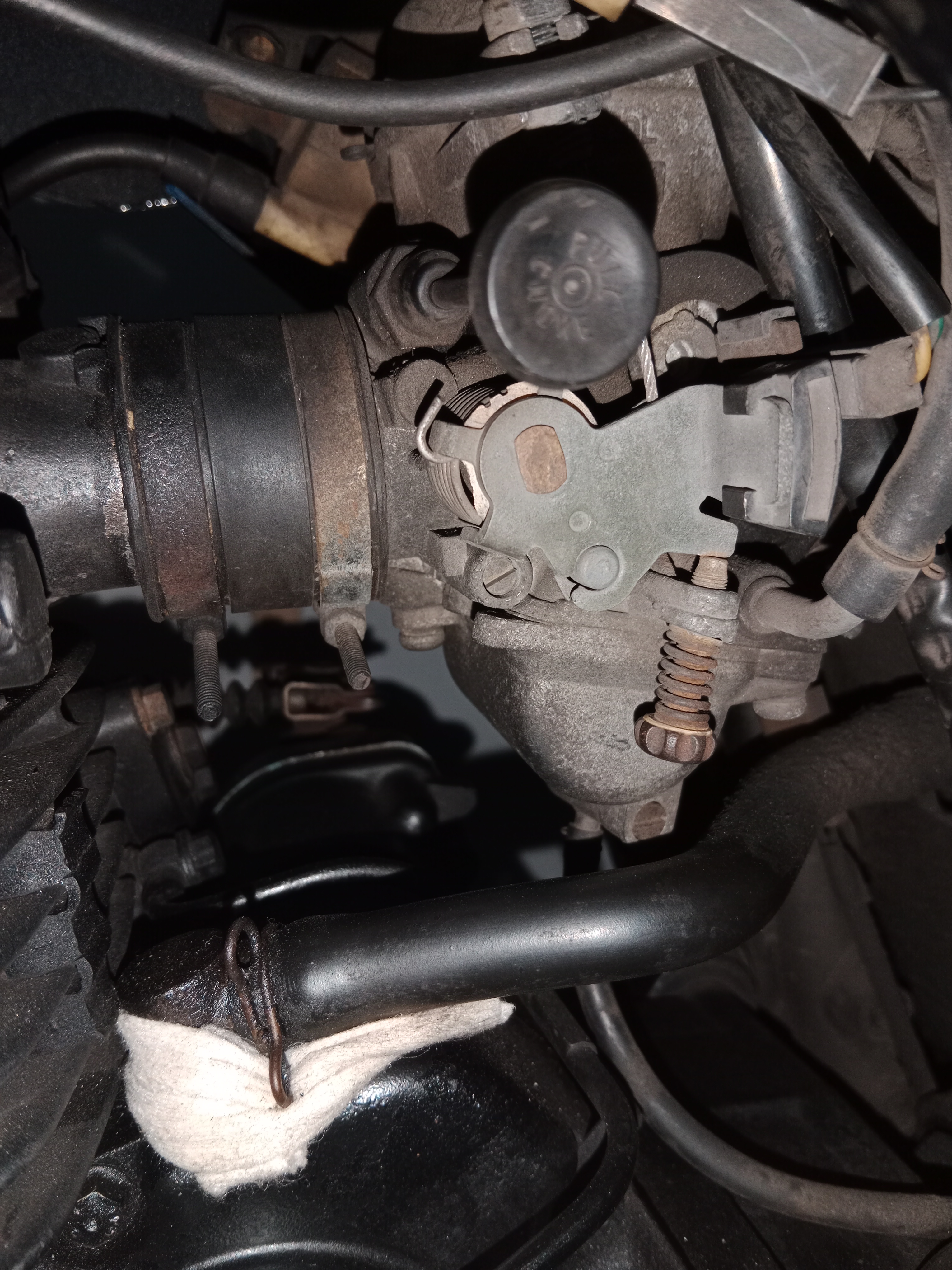

With the new silver based spark plug with taperless tip has arrived. Is time to lean down the pilot jet a bit further to 1.75 threshold limit opening. To avoid from piston back pressuring. The engine torque has improve significantly but the ignition timing still have to be retarded by 1° at the sensor which I can only do some where in two to three weeks time. To this date I still avoid any Platinum and Iridium spark plug for engine temperature safeguarding and electrical consumption purpose which I can utilize it for energy recovery system. As combustion speed increase, engine and exhaust noise energy has also reduce which has been converted more to kinetic energy to the rear wheel.
  • Like 1

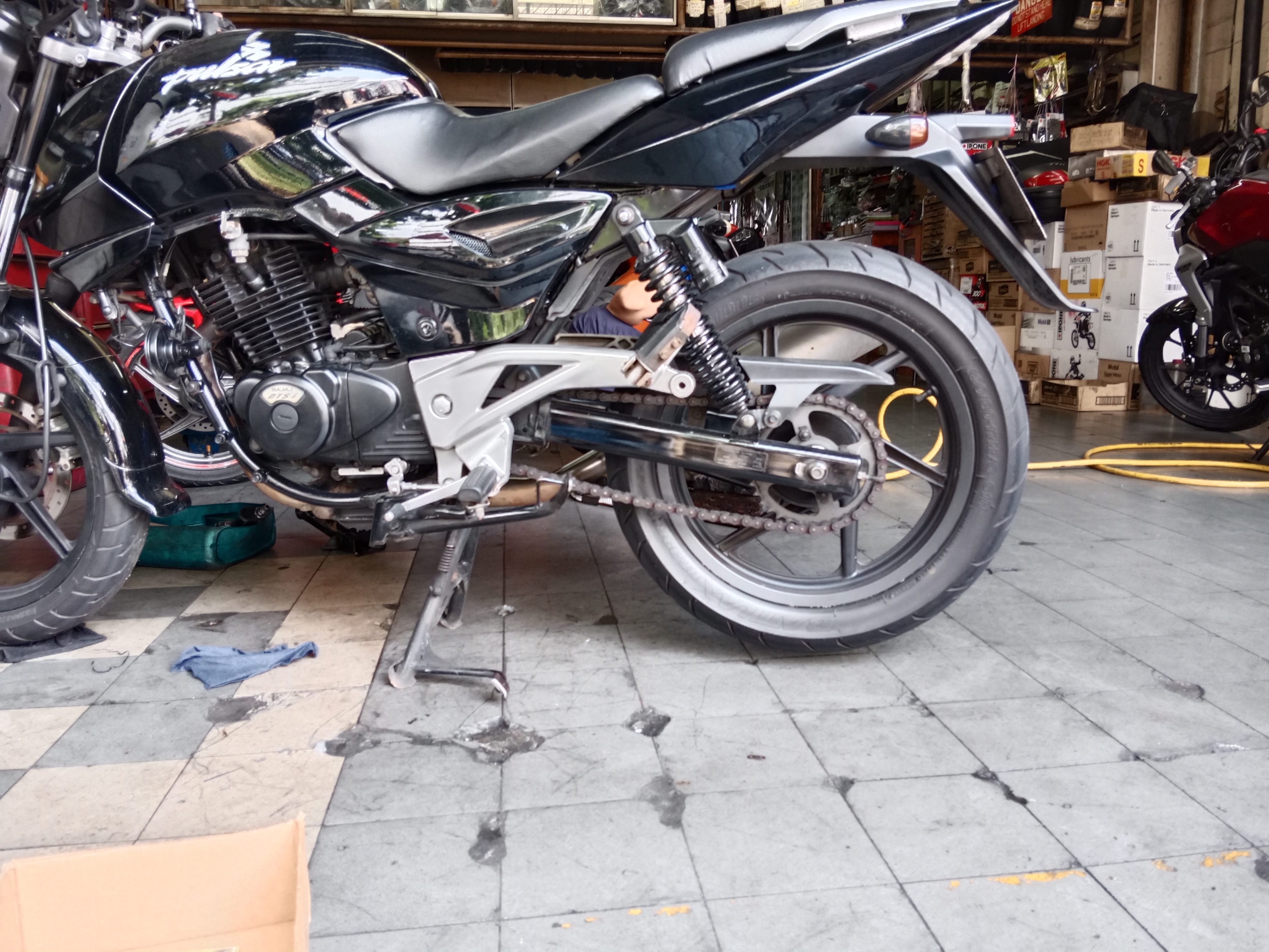

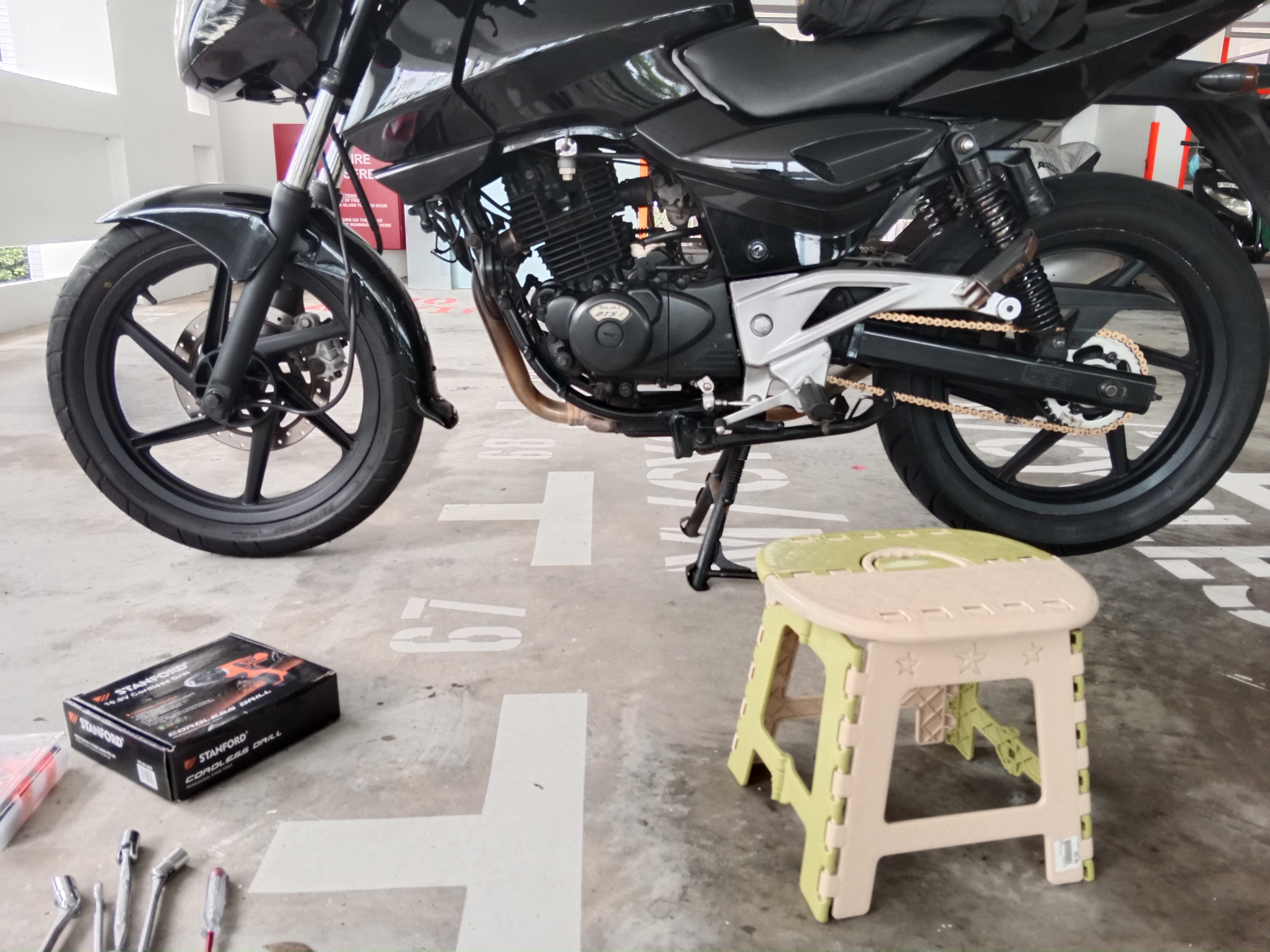

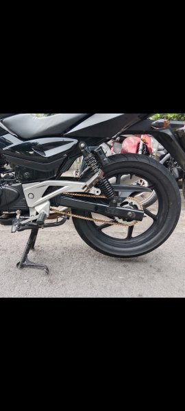

Follow up on weight reduction. For now I just focus on the rear part of the bike where also the chain has to be changed. I just stay with the same final drive ratio but with weight reduction of 600 grams. Converting from 14T/41T 520 pitch to a quieter and lighter drive 15T/38T 428 pitch chains. The sprocket numbers might be suppose to be slightly longer gear but also have to consider the diameter of the sprocket where the chains going around it. Total bike weight loss so far have reach 4.25Kg. Down to 141Kg wet weight.

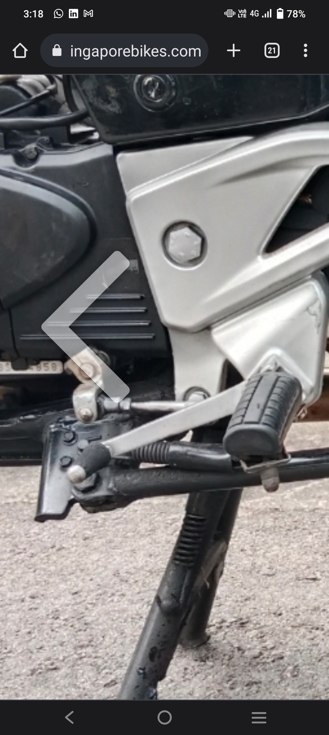

Anyone has had any issue whereby the gear shifter feels very loose or easy to change gear without resistance? Any solutions to this?
Very easy gear change is a good desirable situation that alot would like. Signs of good and precise gearbox design. A slight movable tolerance before gear change is normal. If your bike seasoned bike that has gone for long mileage, signs that the gearbox is well shaped and run in greatly. Depends also on what kind of bike you are riding and also the gear shift external shaft is set to longer travel or shorter travel which you can adjust at certain bike models.
Sort of feel its more "loose" per say. Sometimes cant tell if I already changed gear when riding as well.
Try and see if your bike have a gear lever shaft running along the gear shift lever where you usually kick up and down to shift gear. It might be set too long, it is adjustable for some bike model to suit to your gear change lever movement. Kind of like sensitivity settings.
I believe could be some screws loose? Or clutch plates worn off..
yeah.. check on that screw and all and see if anything loose.. if not, most likely clutch plates..

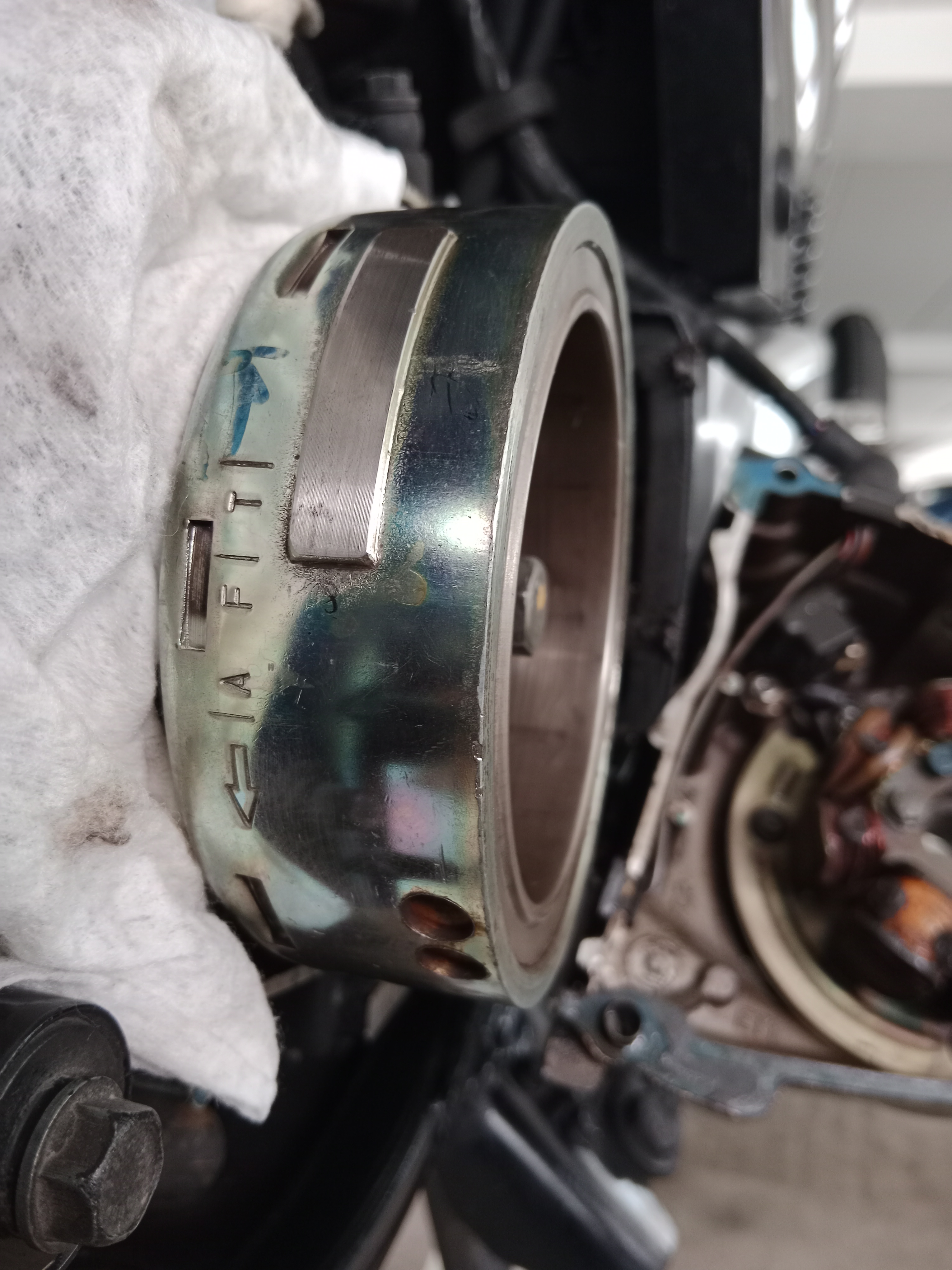

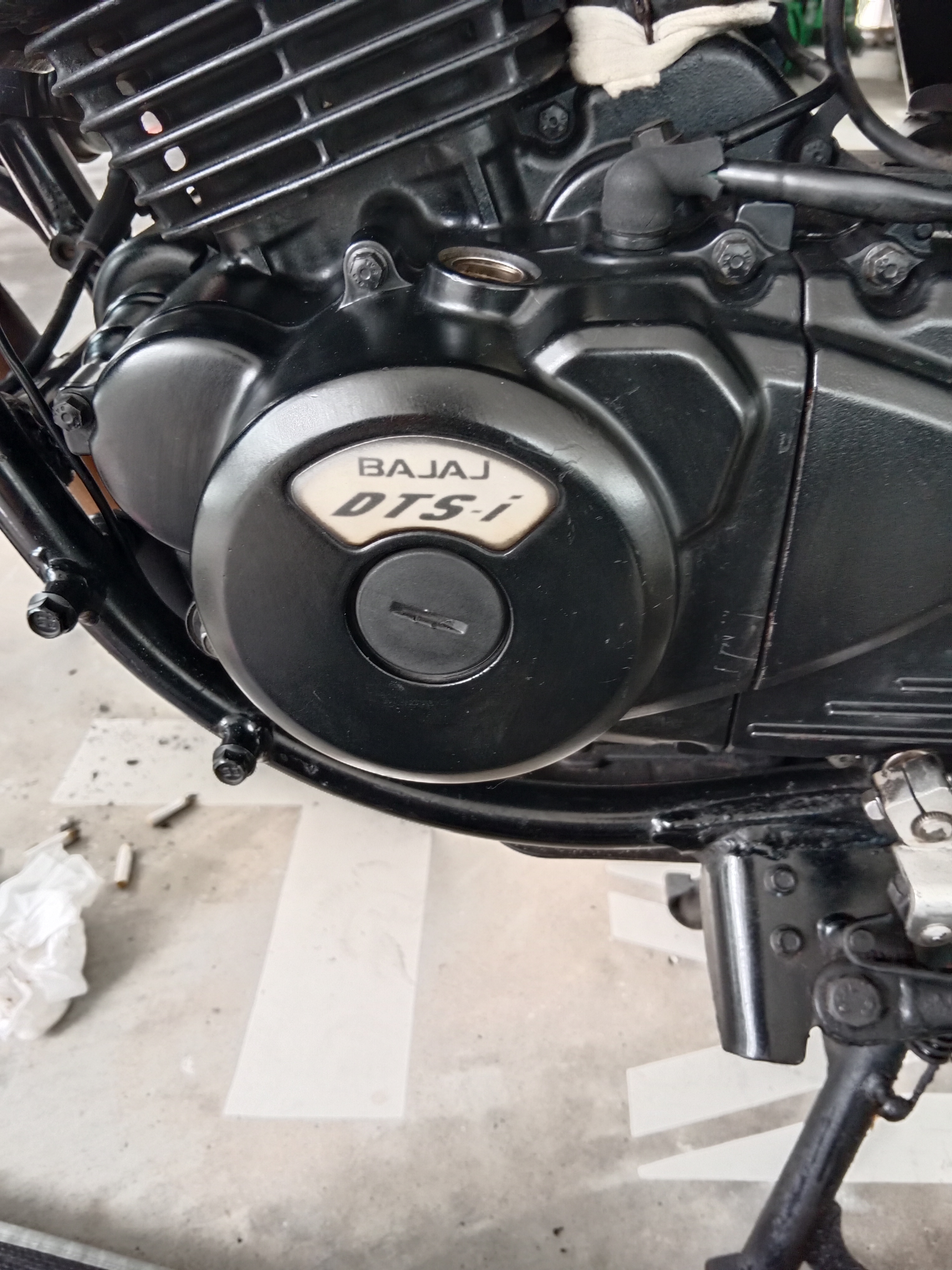

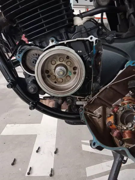

With some free time to spare, is time to do the ignition timing work, starting with only 0.5° retardation on the ignition curve to 9.5° on idling of 1100rpm. Even with spare flywheel in stock in my home. Still have to be careful with this task as calculation have to be done on different kind of flywheel size.
Take opportunity also to clean the front sprocket compartment and also clean the flywheel inner diameter to keep the charging system clean. From top picture start to end task bottom picture. Further idling mixture screw is to set to just 1.5 turns open with further idling speed screw reduce to 1000rpm idle, since the new spark plugs use slightly less electrical power due to silver based the regulator/rectifier will be running slightly hotter due to more excess voltage that have to be converted to heat by the regulator.
With this extra excess electrical power, I can utilize it for power recovery unit as auxiliary fuel from external and also reduce back the reg/rec to low heat making it last a long time without failure since most motorcycle is running on permanent magnet generator rather than a car alternator.
  • Like 1

really nice work.. how you adjust the ignition timing from your magnetic coil?
  • Like 1
A good question 🙂👍🏼. The magnetic coil is not the part of the bike charging system but the flywheel itself. If you see the picture there is a raised rectangular strip on the outer diameter surface, you have to grind it off a bit unlike those with bike with adjustable CDI or ECU. This method is a fix perimeter for the whole range of rpm of the engine operation. Thats where the signal is pick up by the pulser coil for the CDI (for my bike) to fire the spark plug in the combustion chamber of the bike.
Too much grinding will result in excessive retardation of the engine causing loss of power and high emissions of the exhaust due to not enough time for the fuel to be burn to create high pressure for the piston to go down during the power stroke. This is the reason why even when I have a spare flywheel, I still have to be careful not to grind it too much and just start with only 0.5° retardation on the timing.
  • Like 1

I agree, but with some proper homework and proper calculation, mistakes can be minimize and achieve desired results instead. Doing things without any planning can gone to oblivion.

Now, with a baseline done on the ignition timing setting. The most tricky and some work part is after installing the Energy Recovery system. Which is consist of Auxiliary Fuel Unit that I have already installed on the bike and the future HTES on the drivetrain of the bike. The engine has made alot of progress in terms of noise reduction by 20%.
Combustion is more controlled and precise making the idling of the engine to cope at 1000rpm and stable thumping sound, thus less heat is produced with less fuel wastage when is not moving. During rides, observe fuel consumption has reduce by 15% running on RON 92 Esso fuel. Great thing also no higher RON is needed as temperature of the engine has drop significantly, wish Singapore got sell RON 89 🤦🏻‍♂️. But is now constrain by the pilot jet size where it has to be reduce from a stock 17.5 to 15 to allow for tuning play and also for better atomization of the fuel from the carburetor to the engine intake port.
Bike rectifier/regulator heat has also drop alot to just warm feeling by touch on the hand, which indicates I can still draw a bit more excess electrical energy to fuel production thus timing retardation can be slightly further adjusted to increase engine thermal efficiency target of 35%. So have to order Mikuni jet and wait for shipment to arrived before proceed any further.

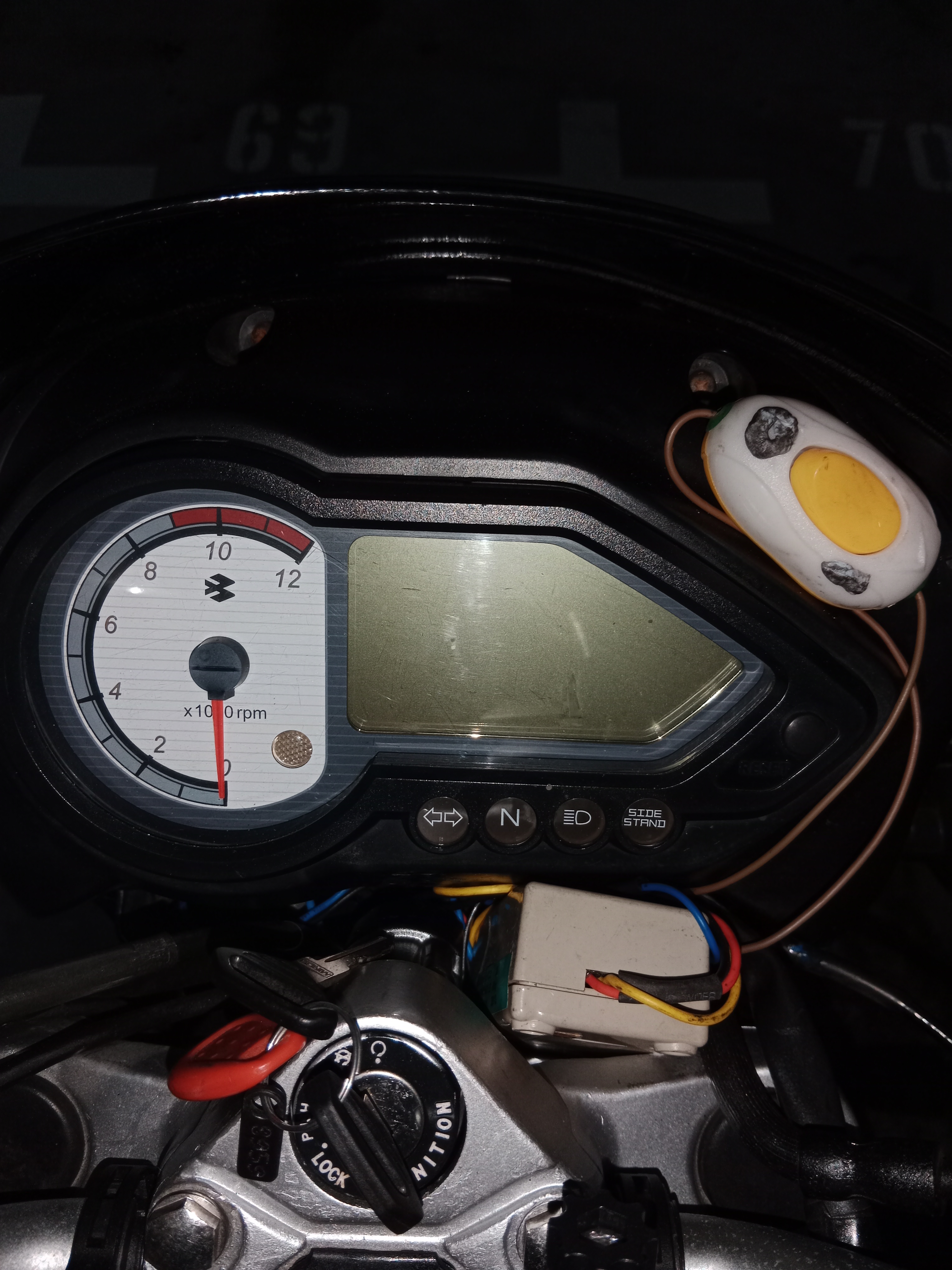

Also the meter that come with the bike was not the original Pulsar 200 meter. Go to change that to classic simple white speedo meter. Last picture taken is the  meter that was taken from the Pulsar 220 which is not sold in Singapore
