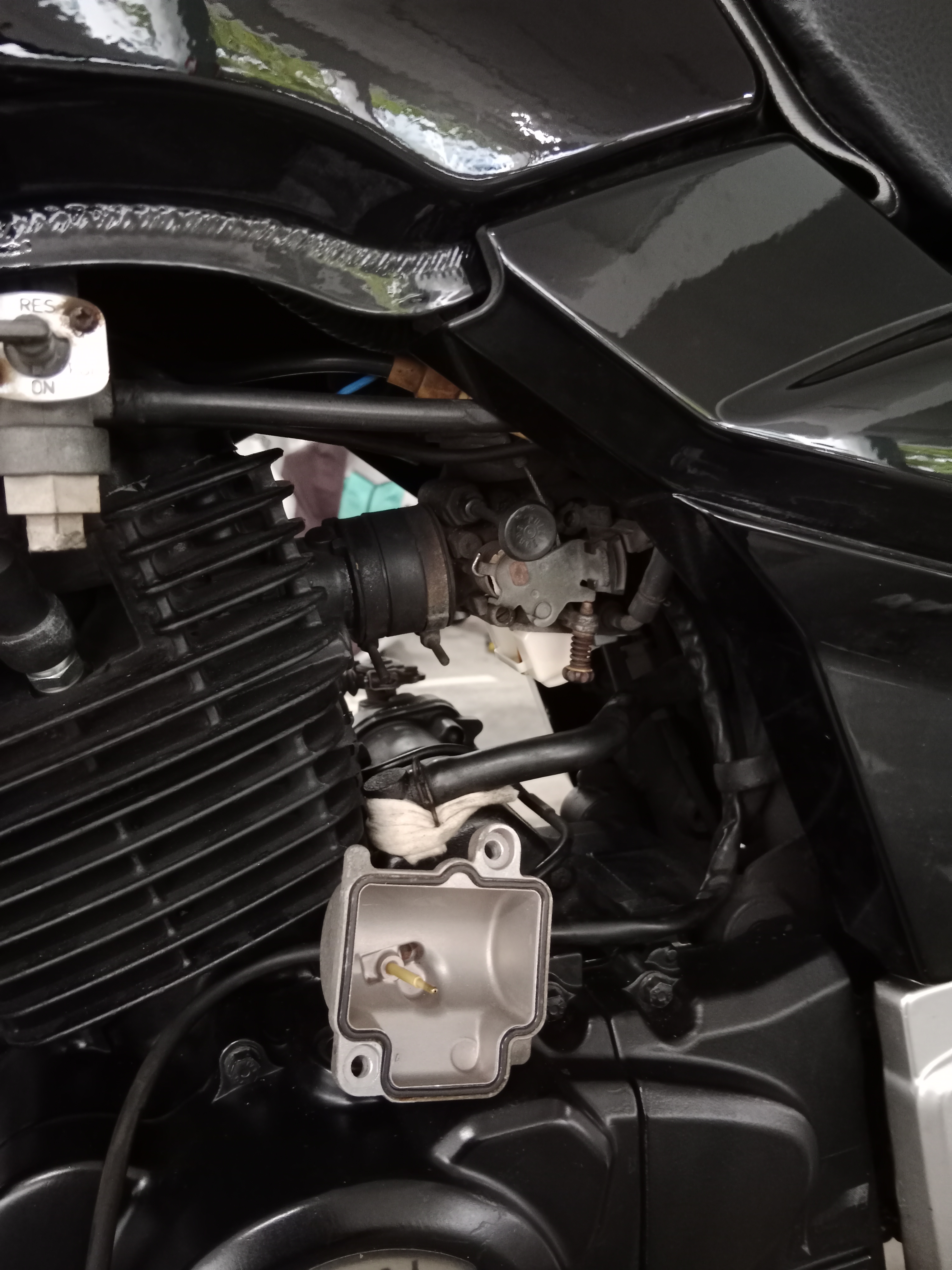

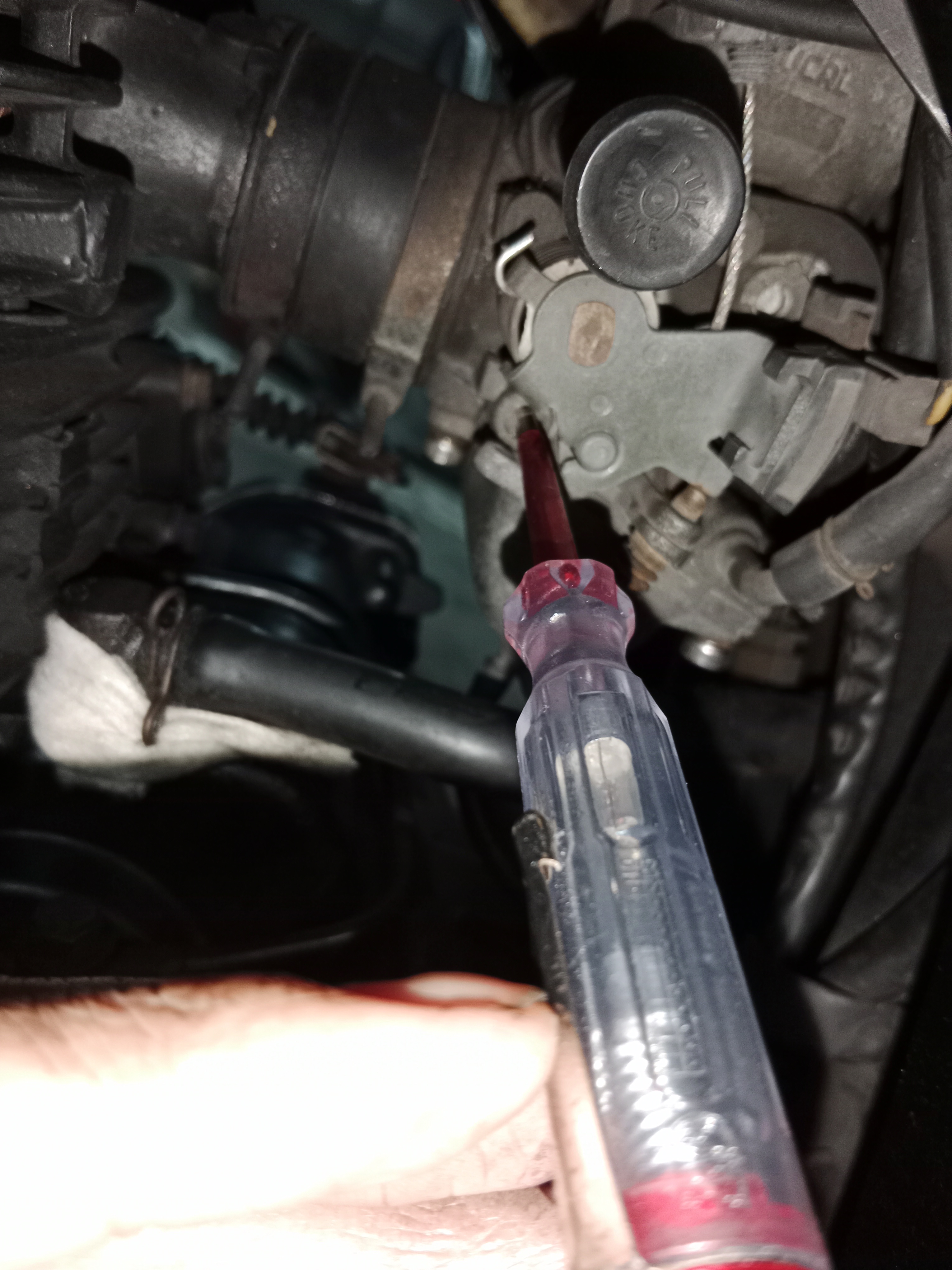

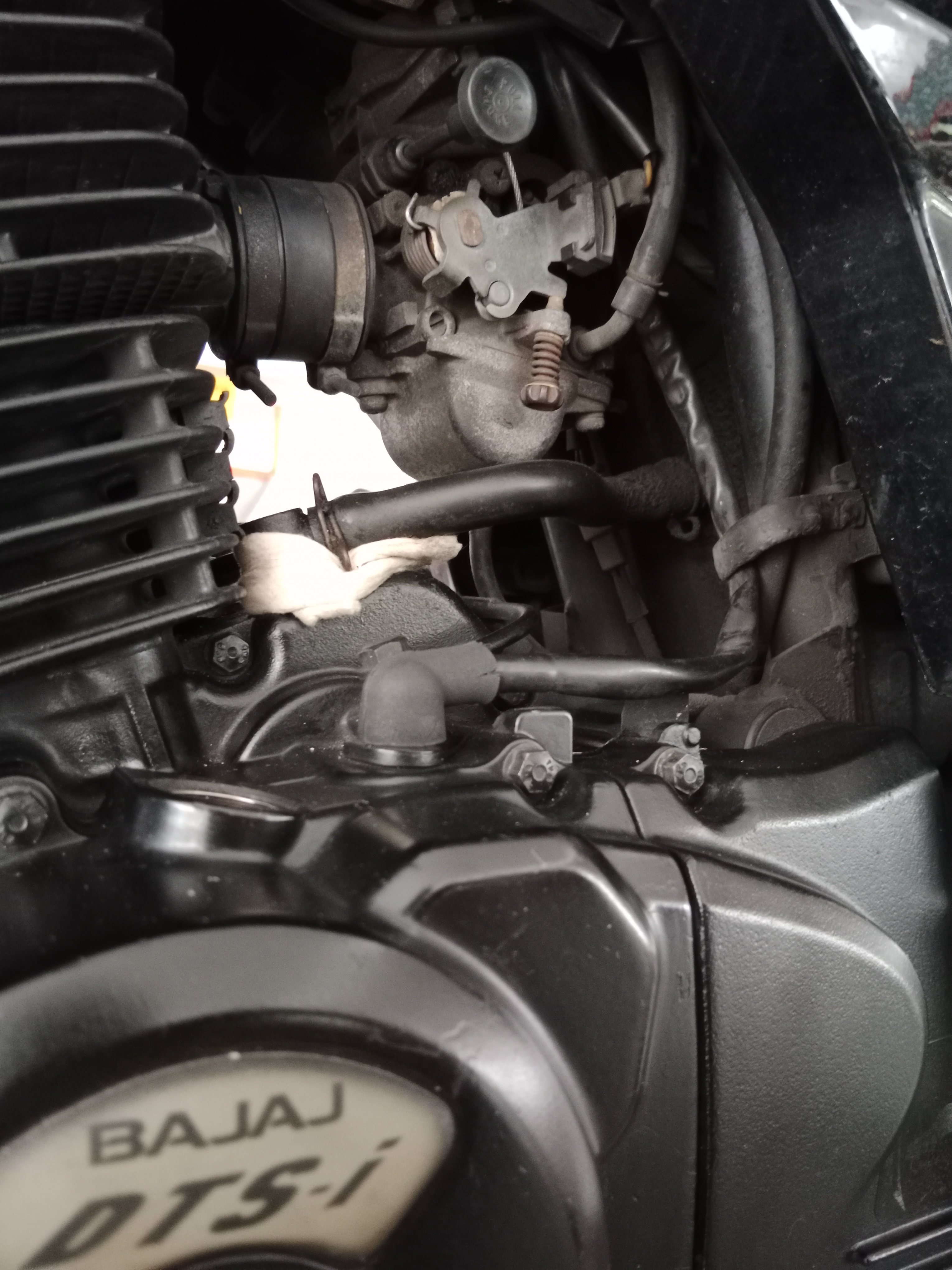

Next step, distance correction and confirming mileage improvement. Doing rough calculation, despite upgrading to bigger diameter tyres for actual distance reading on speedometer and front stability. Confirming fuel saving is at 13% over the stock since first day I buy the bike and also from the factory spec claimed mileage. Actual Bajaj pulsar 200dtsi with stock setting if using a original size tyre 90/90-17 will usually get a actual 38km/l when calibrated on real distance based on a expressway KM mark.
Trying to go beyond 20% increase in fuel efficiency from the baseline mileage. With the auxiliary fuel going online and a pilot jet setting set at 1.5 turns upon. The fuel spray will not be as good giving a slightly sluggish pick up and poor burn pattern. Second picture will be a general idea on a smaller jet but yet giving a better atomization of fuel by the means of air:fuel ratio mixture leaving the pilot jet. thus the screw turn can be back open to roughly 2-4.5 turns idle mixture to 20% throttle opening. Second picture. Taking advantage of also smaller jet due to auxiliary fuel flow is going into the engine. For now ordered the geniune Mikuni pilot jet of 15 and 17.5 ( same stock Pulsar 200). Before further work can be done.
Edited by ConceptFuel
  • Like 1

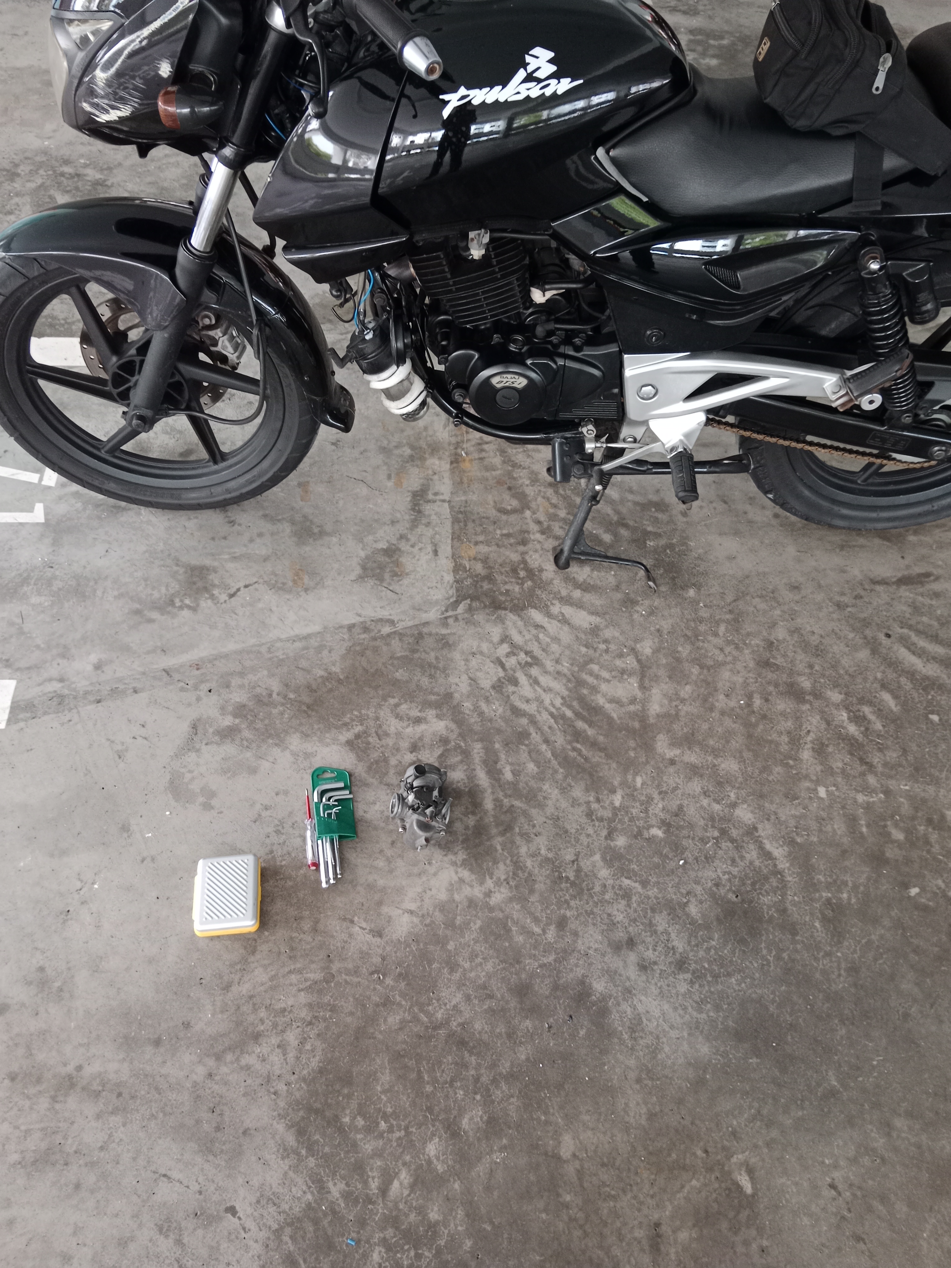

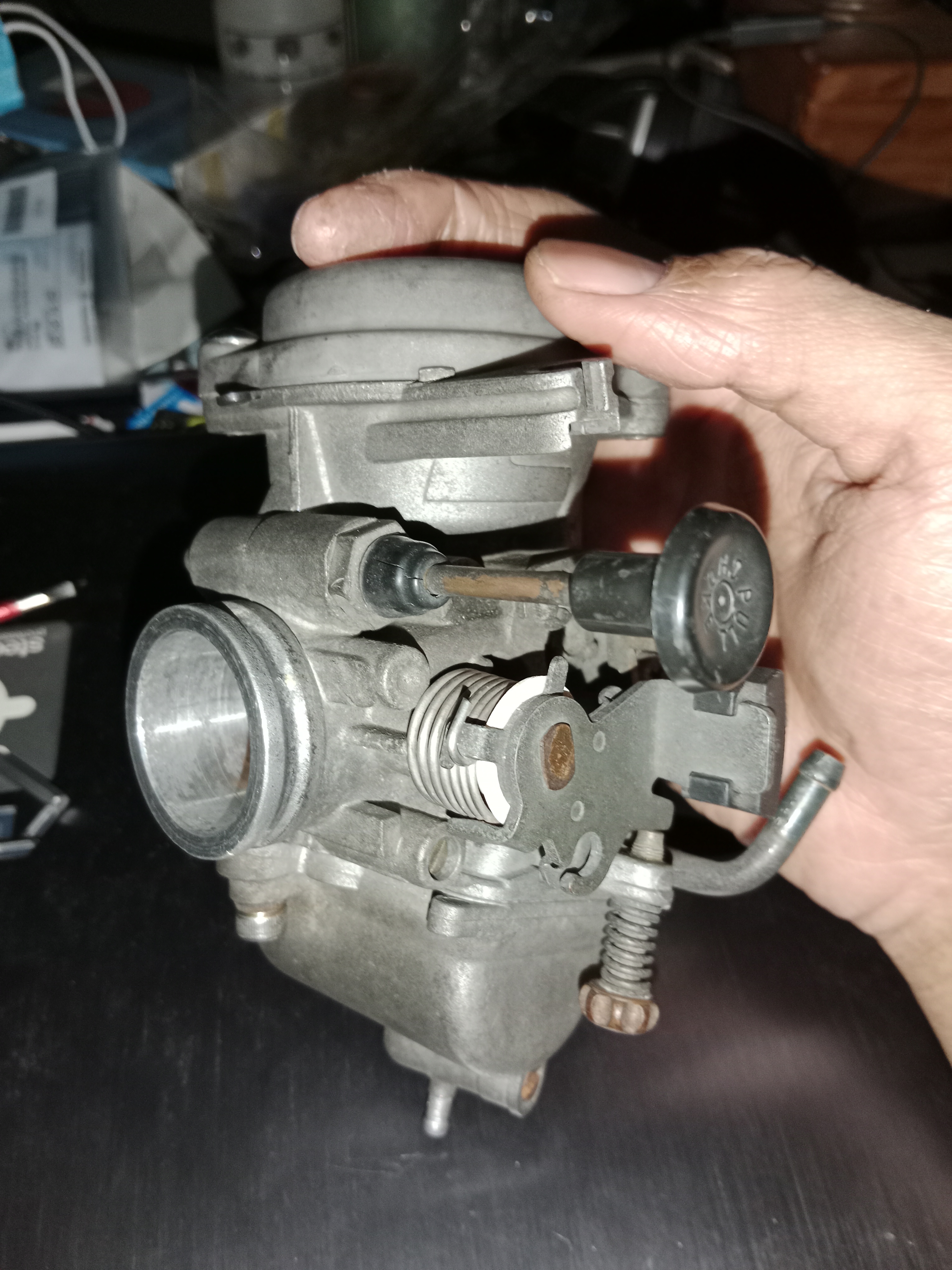

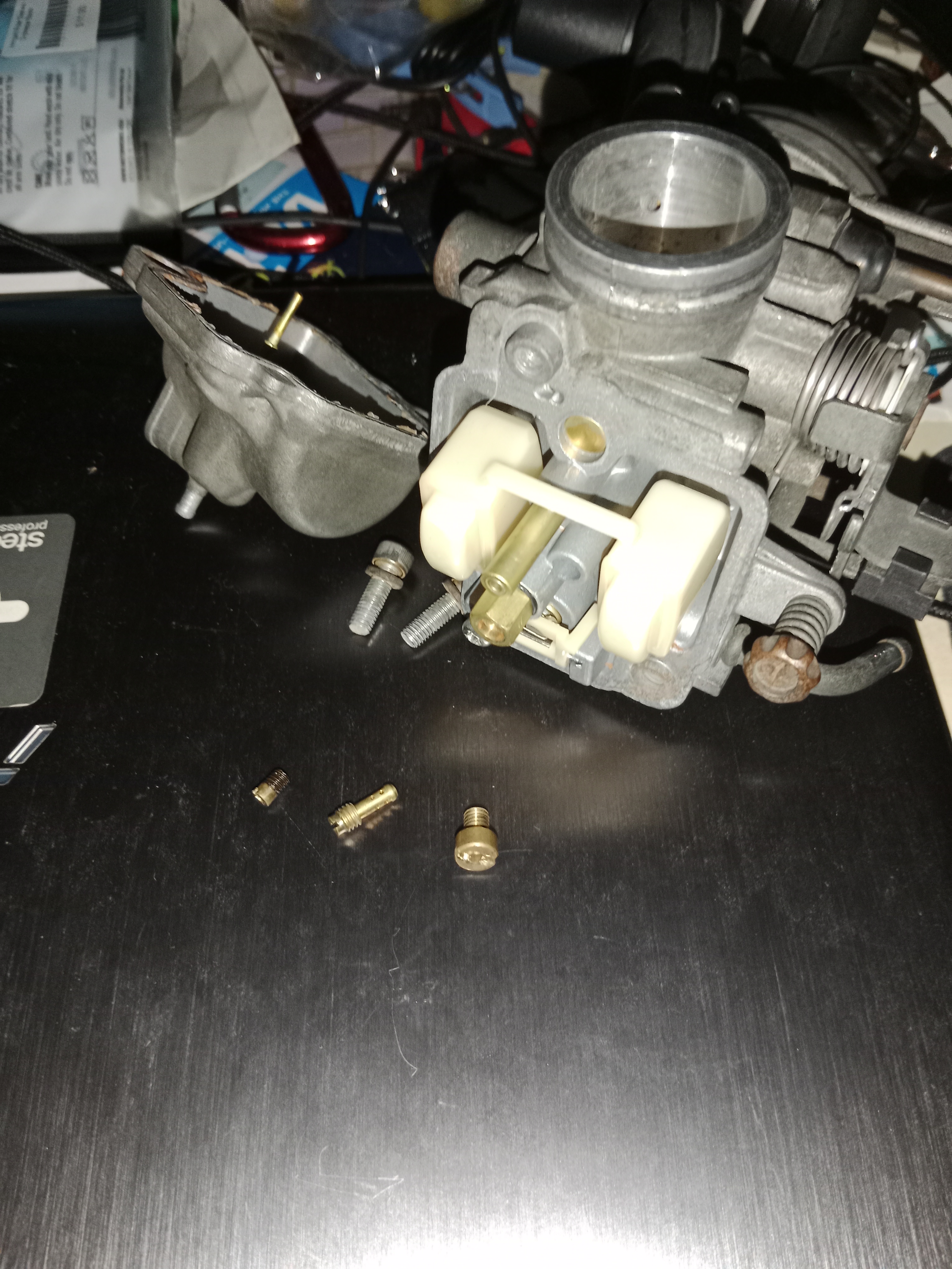

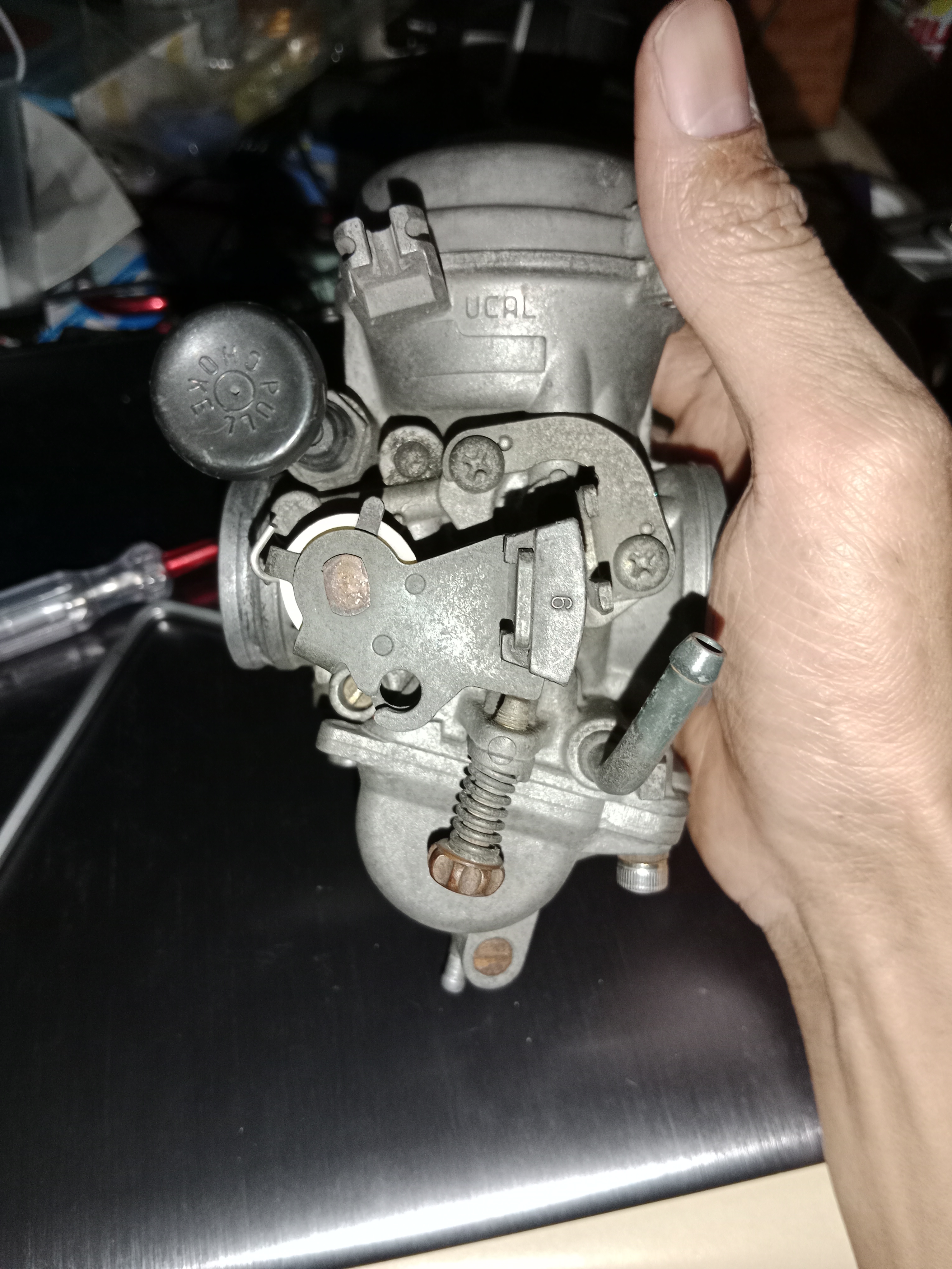

Spare carb in place, inspecting of air jet, pilot jet and main jet. With size number recorded and types recognized, waiting time for shipment is the one alot of use never like, "when going to arrived".
Carburetor can be exceeding a 100 years of technology in the market. But with proper air box size, correct jetting size and design, proper large area air filters can still provide the engine with good feed of power and response. Until one day when the engine is equip with a same wight piston but with a thinner and a gapless piston rings system. The main jet and the jet needle position need to be revised again for proper fuel dosage into the engine
  • Like 1

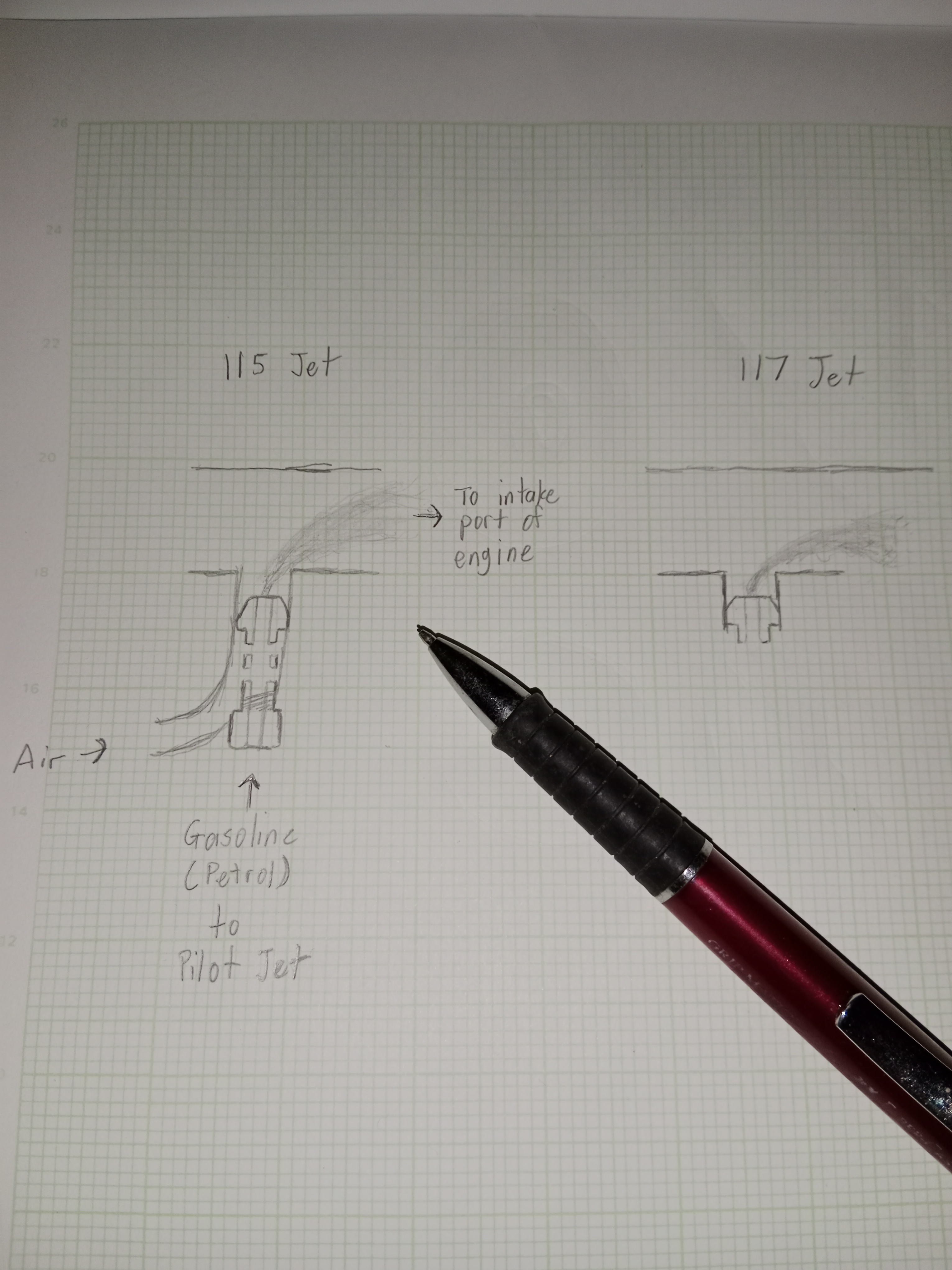

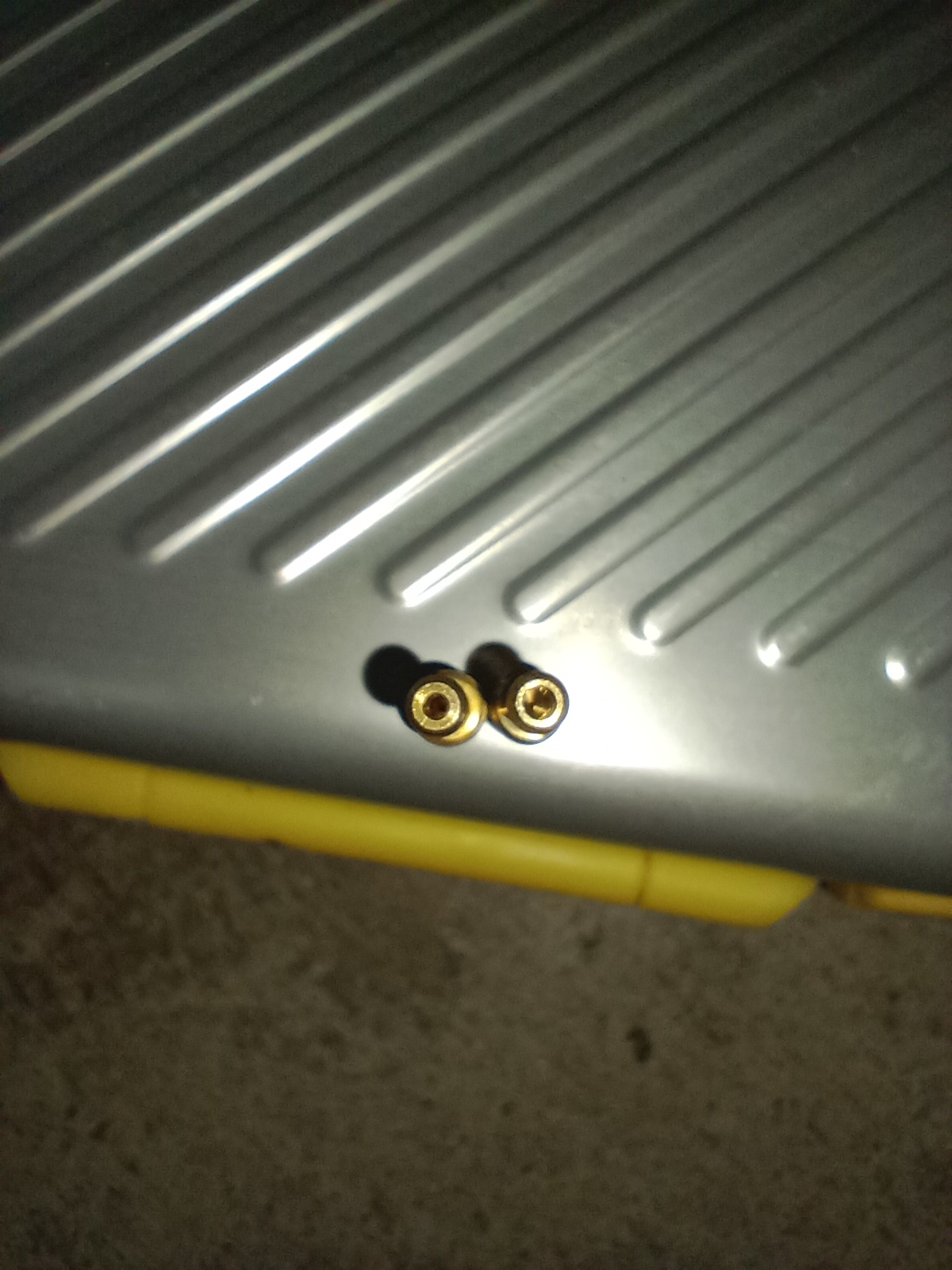

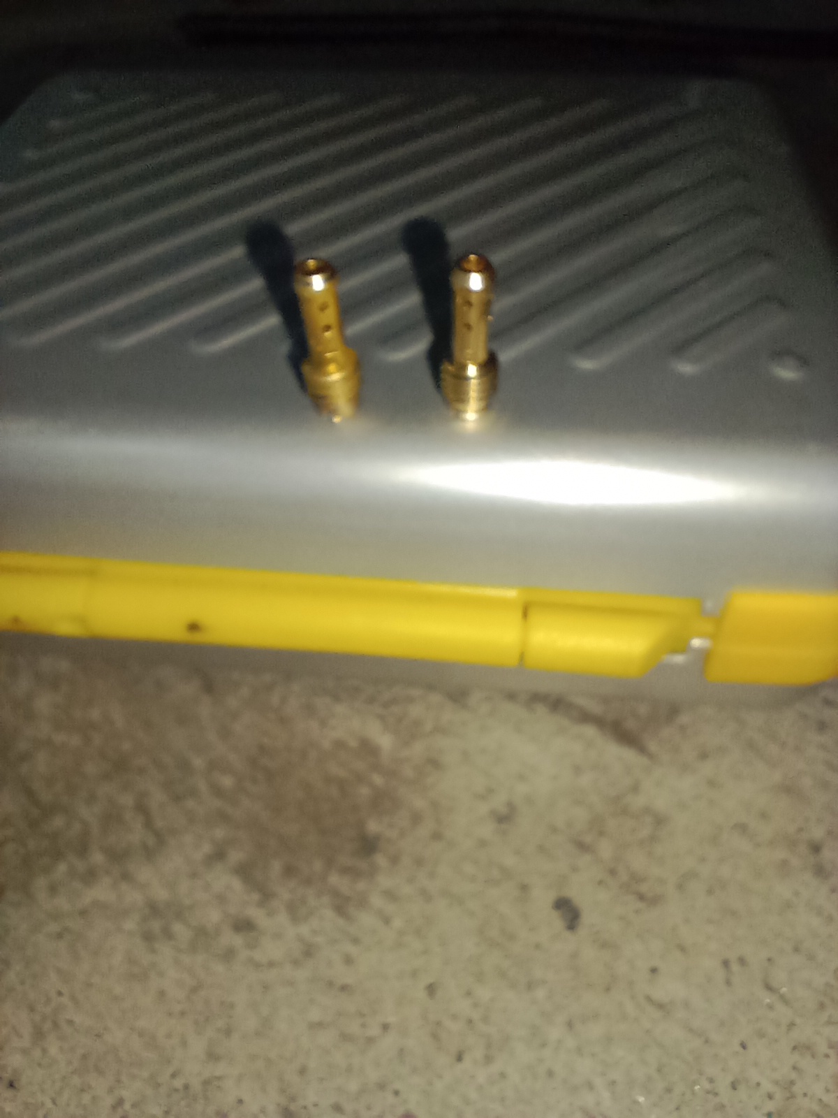

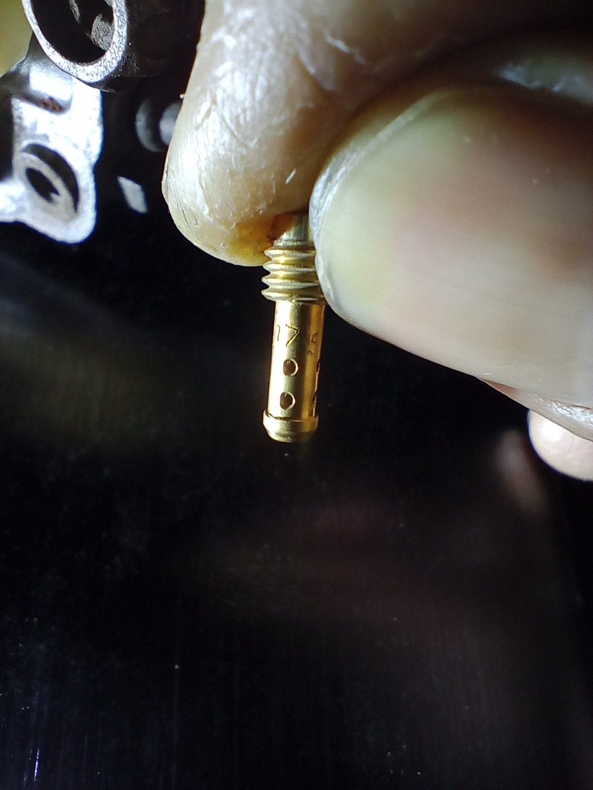

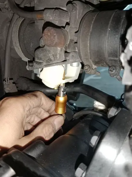

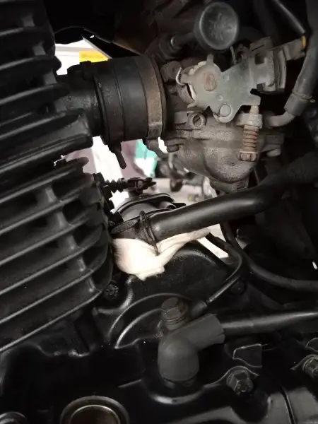

Following up from the past pilot jet received from Australia. Time to swap the jets. Swapping of smaller pilot jet for better fuel atomisation with suppliment auxiliary fuel entering the intake port requires certain fuel dosage rate and also atomizing air adjustment to ensure things are kept at equilibrium as possible on ratio intermix.
Even the factory fitted pilot jet is not a Geniune Mikuni jet making fuel atomization improper just by inspecting the jet throat pattern. With new pilot jet install, setting it back for the pilot jet mixture screw from 1.5 to 3 turns open before going out for ride and set it again from bus stop to bus stop at night. Old jet is left and new jet is right.
Given the supplement fuel produce from the onboard Auxiliary Fuel Unit is also going in via the carb throat, things have to recalibrated again to avoid either increase fuel consumption or worst, con-rod (connecting rod) failure usually bend due to link between ignition timing and air fuel composition. With things setup according to rough calculation and also practical senses like exhaust smell, engine sound and fuel tank touch.
IMG_20220829_185406.thumb.jpg.cd208eb9f8e512870e1e717d0d8fead6.jpgLooking forward to test ride it on a free day around Singapore. Thankfully the carb is still virtually clean due to proper foam air filter is used, external factory fitted fuel filter is clean occasionally and lastly engine oil temperature is maintain to minimize oil vaporization back into the air box and eventually the the carb throat via the crankcase breather line.
As usual pictures are arranged in time order from top to bottom.
  • Like 1
actually sometimes smaller might not be better.. I previously was using a bigger fuel/air jets (not stock) for my KRR.. then my FC can go as high as 38km/L compared to stock 25km/L..
I believe it's the overall settings that makes a diff..
but again.. previously I service my block every year.. so it's slightly different now.. haha...
WAIT WAIT... you didn't close the carb before installing it back? Later the float might get damage....
I agree on your perspective point of view, but looking at the stock pilot jet, is poorly design and finishing at its throat, making fuel atomization poor, thus changing to a same size is wise to do. But also you have to remember adding external fuel source into the engine i take calls for fuel dosage calibration, remember when I told you that I installed a onboard Auxiliary Fuel system that is going into the engine that burns faster than gasoline (petrol)?
Thats one of the reason the jet have to be reduce thus also getting a better fuel atomization at the carb throat before going into the engine for a more through combustion than a sluggish fuel atomization entering the engine take making some fuel unburn (wastage) and going out to the exhaust as carbon monoxide and unburned hydrocarbon.
got you.. indeed.. previously on my bike, even thru I got better FC but my exhaust seems to be always dirty.. 😂

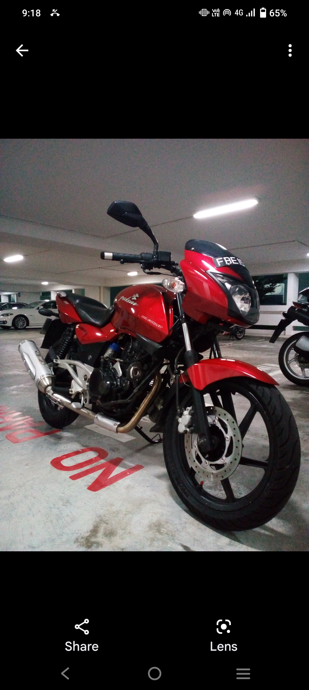

This was my very first Pulsar 200dtsi Version 2 one month before it had to send for scrap when COE ended codename NCC-1578A. Hate to scrap it when it still looks new and run like new after taking care of it very well.
