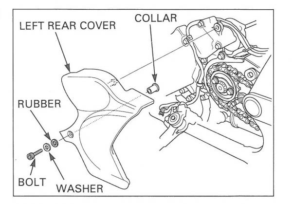

Hi,
I tried to remove the rear left cover to check why my oil pressure lamp will not light up. I already took out the bolt and could loosen the cover but it seems to be held back by something.
Do I just pull it out hard, or is there something else?
Thanks in advance

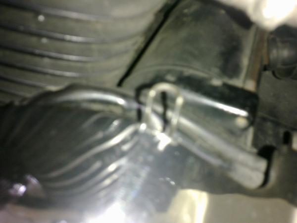

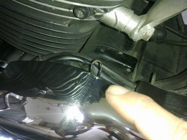

Hi,
Thanks in advance
There is a hidden clip that keeps the cover in place. Its on the top of the case. Use your finger to expose it and just pull off. The cover will then come off. Return the clip after and hide it again.
Hope that helps.
