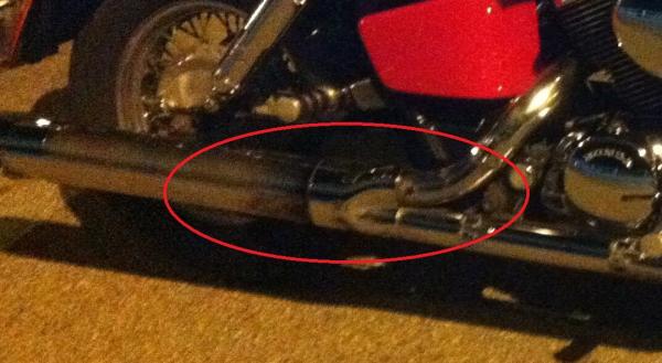

Aniway, Rosli said that my exhaust cannot be used anymore as welding will not help as well. he suggested looking for a second hand exhaust...
I wonder where am i gonna find that...
Which part of the stock pipe is damaged? The main canister or the tubes?

Hi, im not sure which part of the exhaust is damaged. I went to the mechanic and showed him the part that needs attention. After checking, he said that it wont help if do welding as the problem will keep coming back and other parts will eventually crack as well. He said that the exhaust cannot be used anymore. The pic is attached.
That's the area where the downpipes and the cannister are connected. Yes, its very hard to weld that joint. I think there's heavy rusting in the canister link, so the weld won't hold.
The more you weld, the bigger the hole. My advice is to modify it to straight pipes like these 2.5 inch diameter FatStakkers.

Tnx for the advice. I have checked with Ahdi at kallang workshop, he said that he will need to open the exhaust to do a full check. I think I will let him do a full check first and than check if some modifications can be done to use back my current exhaust.
