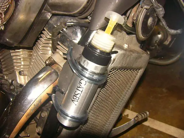

one more problem.
vibration between the bottle and frame, using the 3M weather proof double sided tape, good and sticky
oil will leak from the metal valve also, cos 1 sided is threaded, so u will need to seal as well.
Cheers and thank mepkoh for organizing the DIY
the tube size may be incorrect to have a good seal..solution
1. wrap the threaded area with PTFE tape...the white tape used in plumbing.
2. if the tube is dry afree from grease ..use super glue, contace cement
on the thread ..then slot the tube in ..think this should work..

i noticed that the topping up of the lubricant to the bottle is rather bothersome..
hey found a solution while i was sitting on the throne this morning..ahahahhah
have u heard of the duckie???
yeaH THE TOILET BOWL CLEANER..heheh the curved neck will do just fine for topping up.

one more problem.
im using this spongy thingy which can be bought from popular book store to support and grip it.. Works fine for me...

this is how i isolate the lubricant container..:cheeky:
sweet la.. so huge container
gatsby wet and hard gel... uncle mepkoh you are more extreme than me :cheeky:
