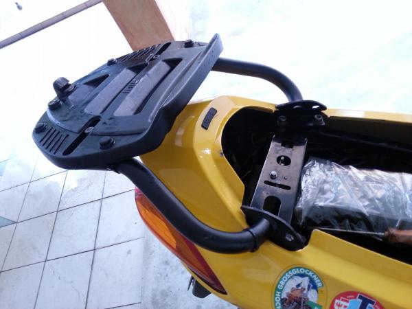

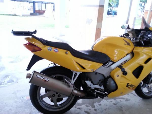

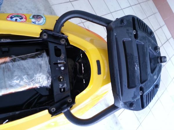

In any case, to help your q, I have a GIVI top box & bracket specific to my current 5th genner. I've taken some pix of the bracket & its mounting so you can assess if it will work with your pannier system.
Hope it helps.

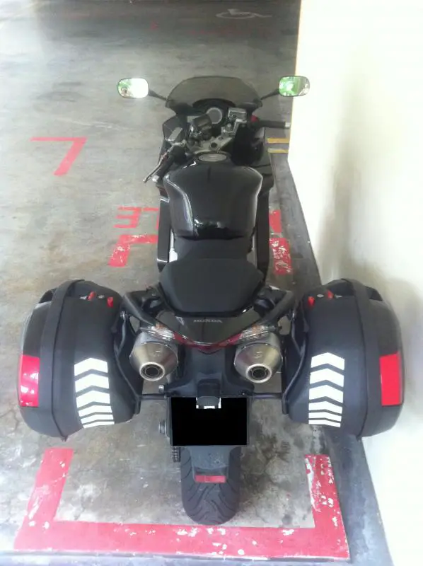

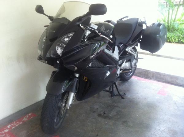

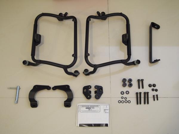

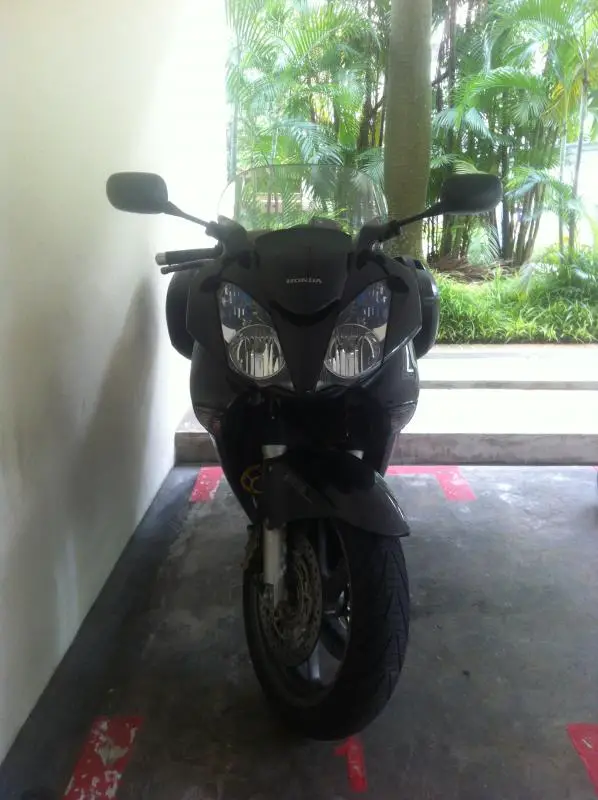

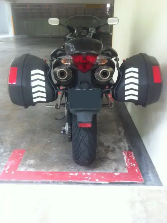

I finally bit the bullet and ordered the GIVI PLXR166 (quick-removable side racks) online. The total cost was slightly more than 250USD shipped to my doorstep. Here is what's included in the package (sans the carrying bag):
Installation was a breeze; all I needed was two spanners and some metric allen keys. However the rear crossbar didn't line up nicely with the license plate bracket, so I could not secure everything together using the included bolts and nuts. Instead I had to mount the license plate using zip-ties and foam mounting tape. But I think having some free-play is actually better because the tolerances are very tight and it's a pain to get everything lined up.
This video made by a Canadian dude helped a lot:
[video=youtube;5igF7Ek-5hE]

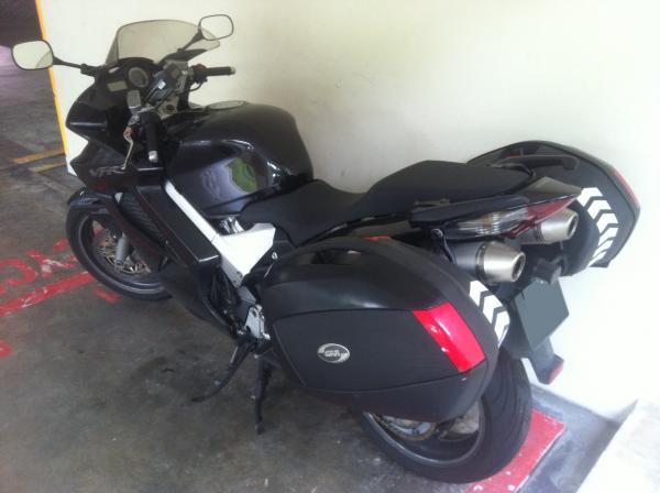

After that, I bought used V35 cases from a fellow SBF forumer. They're not cheap (even when used) but definitely worth the money IMHO. I can put my OGK FF5 (M size) in it with careful positioning and a very slight squeeze. That said, I've been wanting to replace the FF5, so I'll be shopping for a good full face helmet which can fit inside the V35 without squeezing. So if you see a guy trying to fit various helmets into a V35 in the next couple of weeks, that's probably me. :cheeky:

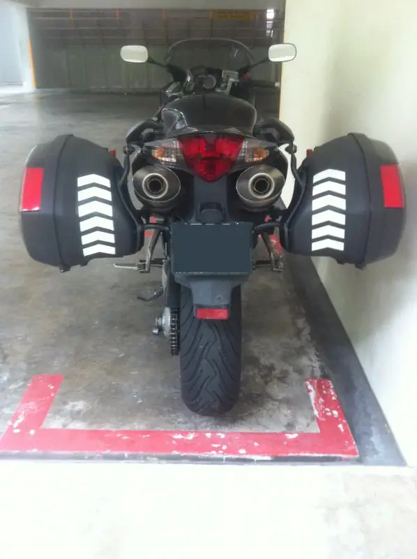

The side cases make the bike much wider than the mirrors, so I had to be much more careful when squeezing through peak hour traffic. The funny thing is drivers seem to start giving me a wide berth. Perhaps they are equally worried that my side cases might hit them?
And here are some pics of the final product, taken with an iPhone 4 and edited in Paint so pardon the image quality.
Edited by rhema83
Looks nice and these boxes also look bigger than my OEM boxes although they always surprise me cause can fit my flip up FF helmet and raincoat with some squeezing. Whats the total width of your bike with boxes now? I'll be looking to fit a top box also just so I can take off the side boxes for normal day to day use (with squeezing) and the side boxes for long range trips with more luggage.
The V35 case can fit a full-face helmet quite easily. The trick is not to put your helmet upright (i.e. bottom of the helmet facing the floor) but to put it on its side (bottom of the helmet facing the bike, tilted slightly upwards; face shield facing the rear of the bike). There is definitely enough space left for a rain suit and gloves.
I didn't measure the width of the bike with a measuring tape; each side is wider than the mirror by about 15-20cm. Whenever I squeeze between cars I play it safe and make sure that I have enough clearance. When in doubt, just slow down and wait for a bigger gap to open up. So far my daily commute on the TPE/CTE takes only a couple of minutes more, but my fuel consumption has gone slightly up due to more frequent braking and acceleration (i.e. brake when the gap is too small, wait, and accelerate through when it opens up enough).

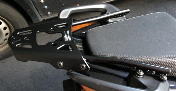

How about SWMotech Rack for VFR800?The aluminium rack will be using the 4 mounting point from the passenger handles.[ATTACH=CONFIG]273262[/ATTACH]

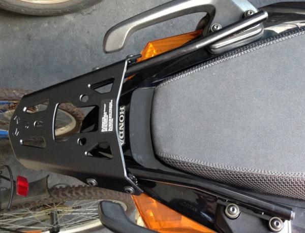

Just to update all on this top box combo with OEM side panniers. I recently received my SW-Motech rack and with some help have attached so now can start looking for top box to attach. See pics for the rack if anyone interested. [ATTACH=CONFIG]286236[/ATTACH] [ATTACH=CONFIG]286237[/ATTACH]
Next will be the selection of top box - will be reviewing Givi selection available in sgp - any other suggestions besides Mah's?

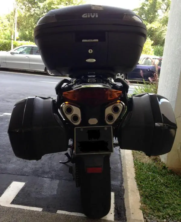

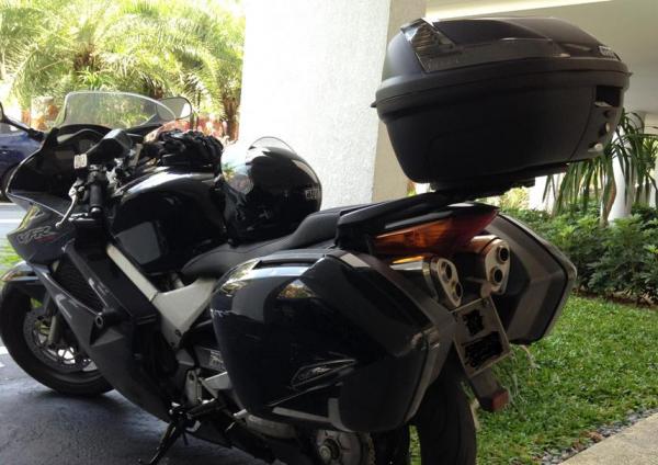

Update as I have added my top box, see pics as attached:
Pretty happy with this configuration and new Givi box looks ok and can fit 2 helmets. Now I remove my side panniers unless I need them and can filter in traffic much easier
