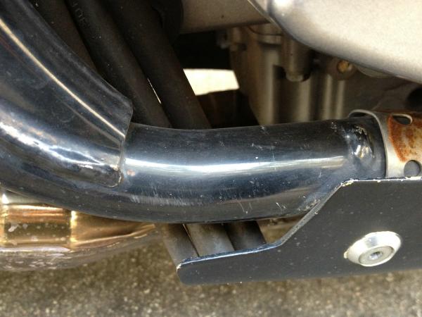

photo1.jpghey guys, i encounter a problem. there is some coolant of fuel have been dripping from my right hand side of the 3 tubes. i have no idea why. it always occur during the afternoon. i went to shop he say either my coolant or my fuel overflow but my fuel was once full and now half. it occur 2 times already. shop say it is nothing. but kinda kan chiong about it. any advice will be much appreciated. thank you in advance.
