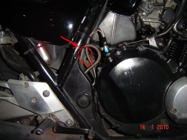

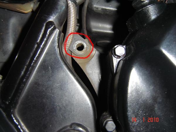

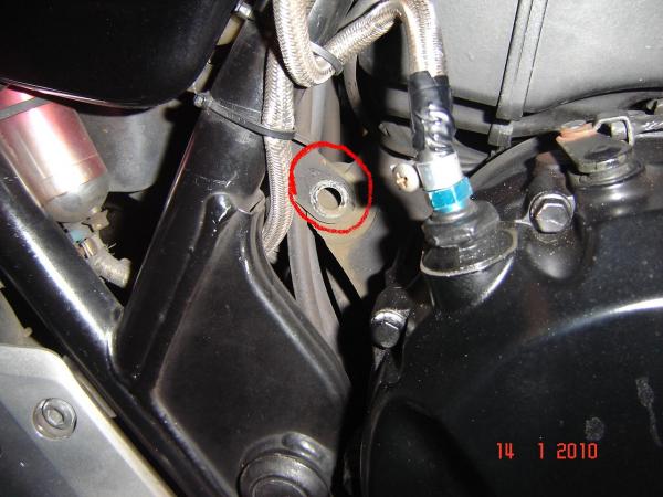

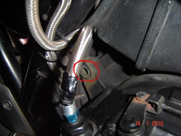

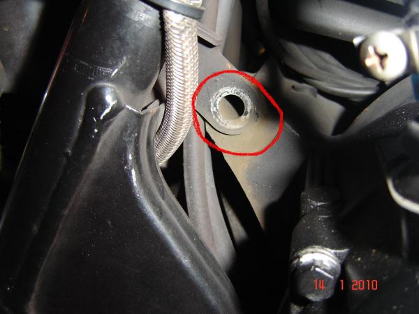

[Q] Hi guys. I have a problem with my vtec 1. Currently, one part of the bike is missing. Its a rod that supports the engine to the frame. In other words, its where the 3-point crash bar is fixed onto. Does anyone knows where to buy that part? The part is circled in red in the pictures. Thanks in advance!
I believe you can get it from Lim Ah Boy..his workshop install 3 point crash bar..shouldn't nbe a problem getting one from them. Workshop is at Kallang Bahru.:sian:
