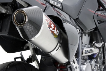

does anyone know how much is motorworld selling this pipe?
i tried emailing them but no reply. :(

abt $1.8k..

thanks for the info buddy.
is it full system? or just the slip on?

Yoshi only had full system for DRZ.. Same one I had on mine..
Wouldnt be crazy to pay $1.8k for a slip-on.. :angel:

1.8 for slip on is crazy. thats why i'm asking for half system. but u already say no have.
its expensive! sobz...
not sure i should spend this money!! argh!
