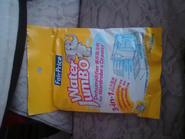

Guest B_E_N
sorry for the delay, as i promised to post the photo of the so call absorb water de thing.
was very busy working.. no time surf forum.. haha
Guest B_E_N
Ya it's work....
But it's wear off fast... after every heavy rain sure need change liao
