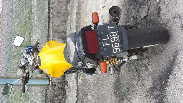

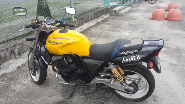

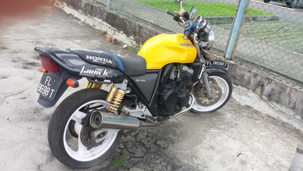

[ATTACH=CONFIG]295582[/ATTACH][ATTACH=CONFIG]295583[/ATTACH][ATTACH=CONFIG]295584[/ATTACH]
MysticMoon,
sure or not this bike was abandoned? as in you saw it there unmoved/unused for a long time?
just my $0.02 :angel:
Goodee hor hot goodee... Mat witz sebastian! :p
This vehicle is lay up until 13 Mar 2014.

Such a waste.

Well, I suppose the owner has spoken...
thread can close already?
Lol I not owner la. My ride is a Spec 3. I did a search of the number plate on OneMotoring. :cheeky:
Anyway, I don't think the owner can park a "lay up" vehicle over there. LTA is supposed to compound the vehicle.

Possible if that add is declared as the vehicle lay up add.. if LTA were to compound every laid up bike, they'll need a mscp at sin ming heh..

swat[/MENTION]_;8095833]Possible if that add is declared as the vehicle lay up add.. if LTA were to compound every laid up bike, they'll need a mscp at sin ming heh..
