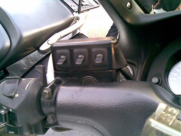

hi simon,
the attach pic light s/w....
Our ST guy install @ san @ $90...
actually it is for Goldwing....
let our ST fellow know....:cheeky: :cheeky: :cheeky:

this thing is call master switch block and can be purchase online . But require shipping to Sg.
http://j.b5z.net/i/u/2099405/i//1500_and_1800_Black_Master_Switch_Block___B52-705M.JPG
