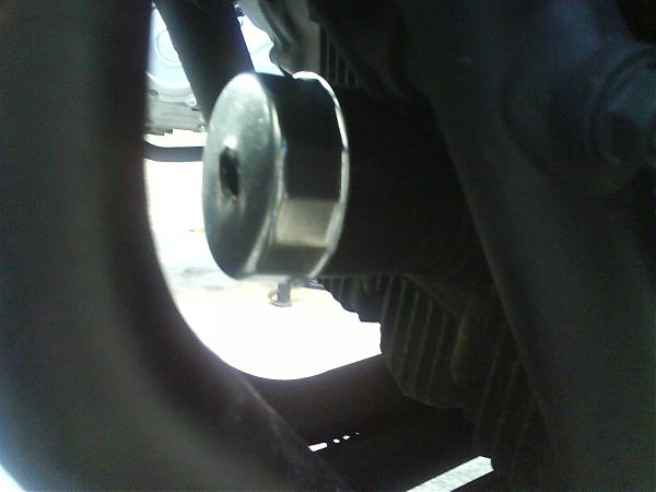

i bought the red carlube 2 pour a can of stp oil treatment into i... bought an oil filter as well.. was abt to change then the nut on the oil filter cap broke off.. now that my oil is drain but my oil filter cap stuck on the oil filter... dunno how now.. cannot change le..:faint:

.. then the nut on the oil filter cap broke off.. now that my oil is drain but my oil filter cap stuck on the oil filter...
Hey Jiaxian85!...very chim_leh!!!...what is this "nut" on the oil filter cap?..Oil Filter cap got nut meh?
Than oil filter is oil filter but what is "Oil Filter Cap"? I kenna Sotong by you leh.
Whaaaa...Got oil filter cap nut?? What is that. Ok now I'm thinking twice about it. Is it because you tightened too tightly? Cos the oil filter states to use 25 - 30N of force. How to measure sia.. :slapforehead:
yes..its very hard to gauge what is 25-30n in torque. Just hand tighten as much as you can and then use a oil filter tool is slightly tighen just a bit. Run engine and see if there is any sippage of eo at the lips..if there is, just a little bit more. I always does that..no problem so far..touch wood. Same goes for the oil sump draining bolt below.

No Oil filter tool! :faint: Haha.
:giddy: .........:faint: How can?...go to LAB area there...the shop next one or two shops down to the one selling stainless steel screws and bolts..go get a Oil Filter proper tool. Its about $20 or slightly more for a good japanese one. Various sizes. need not to buy a handle wench..it comes with a ize 21 or so "C-Spanner" bolt head. You need it..and its a life time tool.

hmm sry sry think i say wrongly... should be the tool for opening the oil filter... have a pic of it.. early in the mrning push the bike to nearest petrol kiosk ask them help help... haha...
btw good morning to all...!!!
Can be easily taken out mah. You need to wedge it out with a long screw driver or just a wooden handle of a hammer or something...kenna like that before oso.
