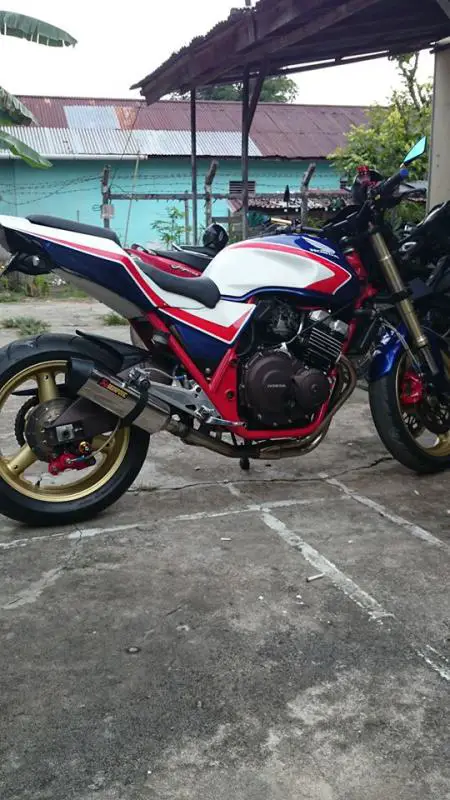

Dear All,
I have get new CB 400 SF, but ther is a problem with speedometer.
As i know inside the original speedometer there is speed sensor (limiter)
I want to ask:
1. Is any one here change the speedometer with after market speedo like KOSO with speed sensor ?
2. can cb 400 operated normally without original speedo?
thank you before i really need help now.

Don't tink meter is the prob..
Speed sensor is just to measure how fast your travellning speed via Engine
Limiter most prolly depends on your cdi

So with or without speedo the motor still run normally?

Just that you will not know if you speeding or not. You might be going 70km/h on a 60km/h road.

For Vtec model n above, u MUST need the Speedo Sensor.. Without the sensor or faulty sensor, your bike will have hard time going past 80km/hr as the speed is measures by engine.. Your speedo Needle will oso not be moving.. But Rpm needle working
(Other model I'm not sure)
Unless your speedo is by the Wheel, then maybe u can disconnect the cable & tape it

yes your diagnostic is true, i can get more than 80 km/h (i just feel it).
but i have old model non vtech... is it same or not?
if i change the speedo with after market?

Non Vtec S4 are all using cable for the speedometer. Less then $20..go LAB git and DIY..simple.
