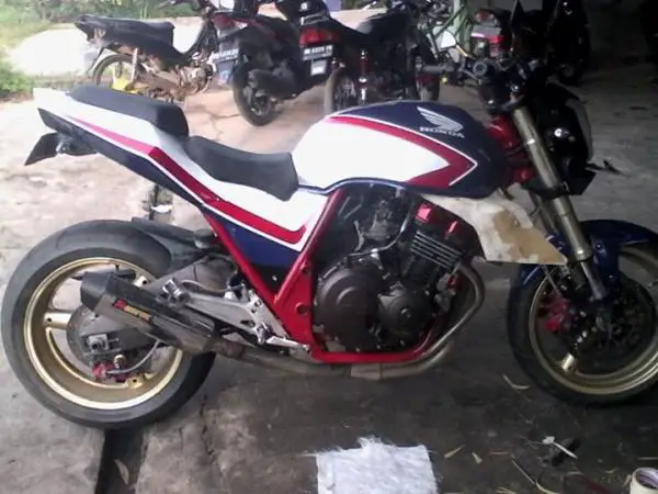

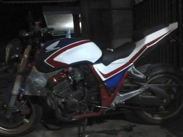

heyyy how are you guys,
her is my update of my cb 400 SF, in progress,
I use CBR 600 arm, R1 upside down, GSXR rim and bore the engine up to 450 CC.
I have test drive in 3rd can reach 180 KPH .
i open the limiter,, i will update soon after all th stuff has finished

Changed so much, why dun just get a CBR1000 or R1?
Yamaha TZR > Kawasaki KIPS >> Suzuki GSX-K >>> Honda NSR >>>> Yamaha RX-Z >>>>> Honda CB400 Ver S >>>>>> Kymco X400i
