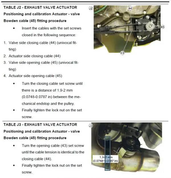

After checking out the service manual, I think the Exhaust Valve Actuator (EVA) can be disabled & taken off the bike.
My guess is it's there to ensure compliance in sound emission when the bike is in neutral gearing.
If you can live with the red service light on all the time, why not?
Check out the attached on the EVA unit & the cables attached to it..
It's kind expensive for the small pulley unit plus 2 cables to go above 600 bucks..
I bet the cost is like less than 50 bucks for some plastic & metal wires..

meaning if i take the eva out its ok? feel like taking it out and find replica of it IN A CHEAPER WAY...
btw u tried? my eva is kinda annoying man the sound getting worse

Make sure you have at least 3 hours to do the headers.. It'll take a lot of patience too.. After wrapping it & securing the ends with stainless steel pipe clamps, start the bike.. You'll have a good time with the smoke for at least 15 minutes.. It smells like rotten eggs too.. Haha..
I think removing the EVA should be okay.. The function of the EVA is to "mute" the exhaust note while not in year.. Correct me if I'm wrong..

Am the owner of Tuono V4r. Since I can't find a thread on that bike, I decided to be a lurker here instead! Regarding the valve actuator, looks like some guys have done it without getting service lights:
http://www.apriliaforum.com/forums/showthread.php?262671-V4-exhaust-valve-cable-disconnection
Have you managed to do it? How is the performance up to 5k RPM now?

hmm will try it... but i seriously need to change that $600(EVA) stuff man. whenever i on my bike sounds getting worse.... or can i take it out instead? i dont mind the service light coz it sometimes light up for no apparent reason especially after bike wash... btw ani1 is welcome here :) its always quiet here since my fren vondy sold his bike!
