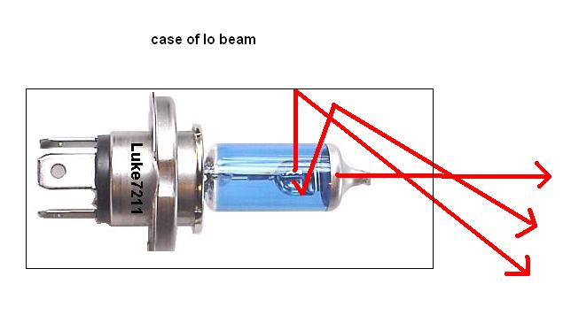

Let us have a look at a H4 bulb. 1st case, lo beam
http://img409.imageshack.us/img409/1876/loxn0.jpg
you shlf have noticed that there is a small metal cap under the lo beam filament. this is to avoid beams from throwing upwards. confused? read the next post :)

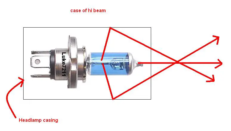

now the 2nd case, hi beam
http://img409.imageshack.us/img409/374/hibeamst6.jpg
u can clearly see that the naked filament (which is the hi beam filament) produces light that is reflected everywhere in the headlamp casing, causing light beams to be thrown upwards, and downwards ---> function of hi beam met.

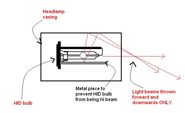

Hence, for your H4 HID, make sure there is a metal cap that prevents the HID from being "hi beam always". else, it is going to irritate many many rd users which i dun wish to see.
a case of H4 HID w/o metal cap causing irritation to other rd users
http://img101.imageshack.us/img101/3497/hid1bd0.jpg
No more regrets.
a case whereby a H4 HID bulb is manufactured correctly, with a metal cap under the HID bulb.
http://img101.imageshack.us/img101/2137/hid2qo0.jpg

This is the correct way of manufacturing a H4 HID hi/lo bulb
http://img88.imageshack.us/img88/3675/h4hidbulbasdvl6.jpg
there are other H4 bulb types which are manufactured wrongly i.e w/o the metal cap. so i hope u guys can use HID responsibly.

for H4 HID, when u on headlamp (which means lo beam), your HID lights up. when u hi beam, by right, the HID auto ceases and the halogen lights up.

:confused: let say if the headlens is frosted glass, then having the metal or not doesn't really matter, cos the light is diffused by the frosted glass.

aiyah! i think some engineers in philips, hella and osram deserve to be sack! they have super-duper degrees, phd and decades of manufacturing experience also useless. simple thing like adding reflective plate at the bulb also dunno, make their company produce bulb "wrongly" and sabo millions of their customer by making them irresponsible road users.
then again, maybe they already know, but still go ahead with that "wrong design" because that will make high beam to shine "higher"? these people dunno that "High beam" is suspose to shine low lah... if not bad for other road users.
i alway wonder why the headlight reflector is bowl-shape and not cyclinder/tube shape like what paiseh draw. i use to think that maybe that shape helps to "concentrate" the light from the bulb to a more accurate direction. then again, maybe the headlight manufacturer also "manufacture wrongly"... paiseh confirm have better design! more considerate, more futuristic!
i think ah... having a reflective plate on a bulb is a solid and useful idea for headlight with cyclinders/tube type of reflector lah... but i think quite useless for those "wrongly manufactured" bowl shape relector. wasted siah... if those headlight manufacturer and those overpaid, phds bulb designer never realized their mistake, this great hid bulb can oni be use as a marketing gimmick to differentiate themselve from the rest of the true hid market now.
i am very sad that such a good and futuristic design like that go wasted...
