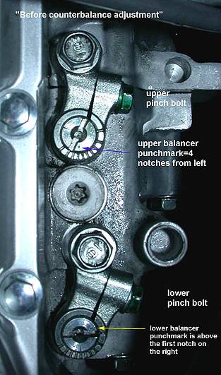

How to adjust your engine balance shafts
Required tools: 5mm allen wrench, 10mm wrench, screwdriver. All are available in your ST1300 tool kit.This job is a bit easier if you also have a work light nearby to help you see what you are doing.
The first few steps must be done with the engine cool to the touch.
Remove the black fairing nose piece. To do this, remove the three nylon rivets under the nose of the fairing, then two philips screws and two rivets on the nose piece. You can pull the nose piece out without removing any other fairing pieces. The adjustors are on the front of the engine on the left side, under the clutch lever.

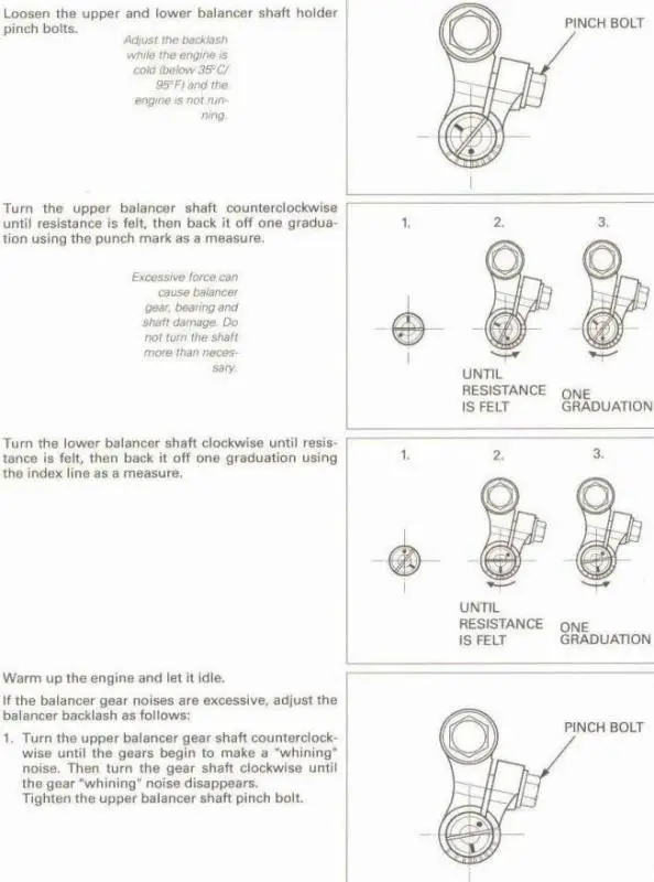

Using the 10mm "bent" wrench in the Honda toolkit, loosen the pinch bolts. Don't loosen too much, or they will rotate on their own when you warm up the bike. Just loosen them enough to turn the adjustors.
Locate the punch mark on your adjusters. Adjust the upper balance shaft first, and the lower shaft second.Upper: turn counterclockwise until resistance, then back off 1 notch.Lower: turn clockwise until resistance, then back 1 notch. This will get you very close.

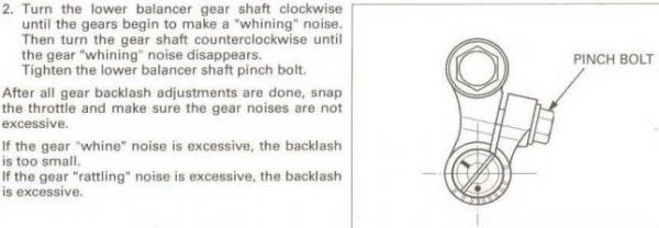

Now start the bike and let it warm up. While the bike is running you can fine tune your adjustment.Upper: turn counterclockwise until squealing is heard, then back off till squealing stops.Lower: turn clockwise until squealing is heard, then back off till squealing stops.
Rev the bike a few times to check that neither whine nor rattling are excessive. Readjust balance shafts as necessary. Turn the bike off.
Tighten up pinch bolts. Attach fairing nose piece.

Page 12-12 from Honda ST1300 Service Manual

Some riders have complained of excessive engine whine and/or transmission noise. Some riders have complained of excessive engine vibration. It has been found by a couple of riders that their balance shafts were mis-adjusted, and adjusting them cured the noise and vibration problems.Full instructions for adjusting the balance shafts are here, or in the service manual. It's an easy job. Symptoms of mis-adjusted balance shafts: too tight = excessive engine whine. Too loose = gravelly sound seemingly in transmission, especially when accelerating from low RPMs.
