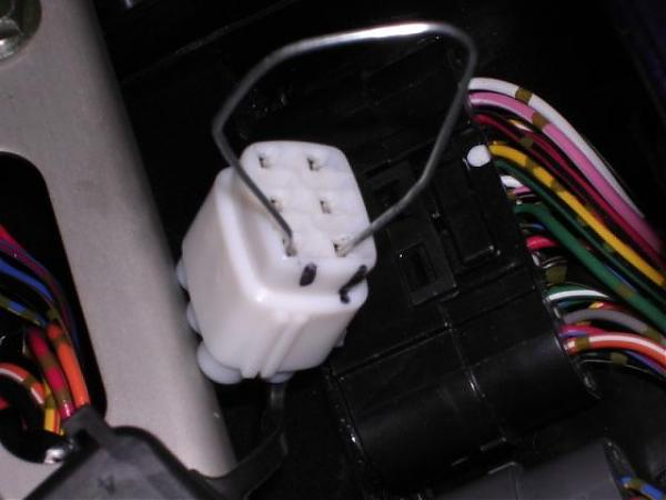

The light disappears when I started the bikes again so it seems a come & go error... Anyway thanks for your advice again and will try the paperclip method to connect the two wiring ends.

Is it something like this??

Thanks Bro dirtbag & Bro singkiwi.

from http://www.gixxer.com/forums/showthread.php?t=174828
Location of dealer mode switch and how to get the codes.
The dealer mode connector is under the tail cowling on the left side of the bike, near the regulator/rectifier. It will have only two wires going to it. It is is small white connector that does not plug into anything, and has a rubber cap on one end.
BLACK W/ GREEN BAND Wire with a WHITE STRIPE and a
WHITE W/ GREEN BAND Wire with a RED STRIPE
you just use a paper clip to jump the two wires together in the connector. this is for models with 16 bit ECM's
It doesn't matter what the question is, the answer is more power!
Thanks for the detail explanation...
