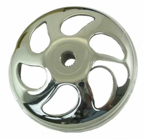

Just want to check. There seems to be some diff b/w 2011 and 2012 model S3 125. I notice the brake assembly at the rear is different. ALso, most importantly, is the earlier 2011 125 version SOHC or DOHC?
Secondly, I notice the clutch bell comprises of metal parts welded together on the standard model. I like to gather feedback of upgrading to machined after market clutch bell which are lighter yet more sturdy. Would it help to improve the performance of this bike (i.e. lower weight yet strongly, lower inertia and faster speed)?
