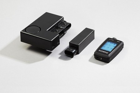

Hi. Anyone have any good alarm to recommend? I'm thinking of getting the scopio is900. Thanks
Sent from my GT-N7000 using Tapatalk
I'm thinking of getting it too. PM SEND
Edited by Murpies
[ATTACH]304528[/ATTACH]
Motoworld is the distributor . Selling at $500
Hi. Is it inclusive of installation? Any issue with warranty? Or must install at pml?
